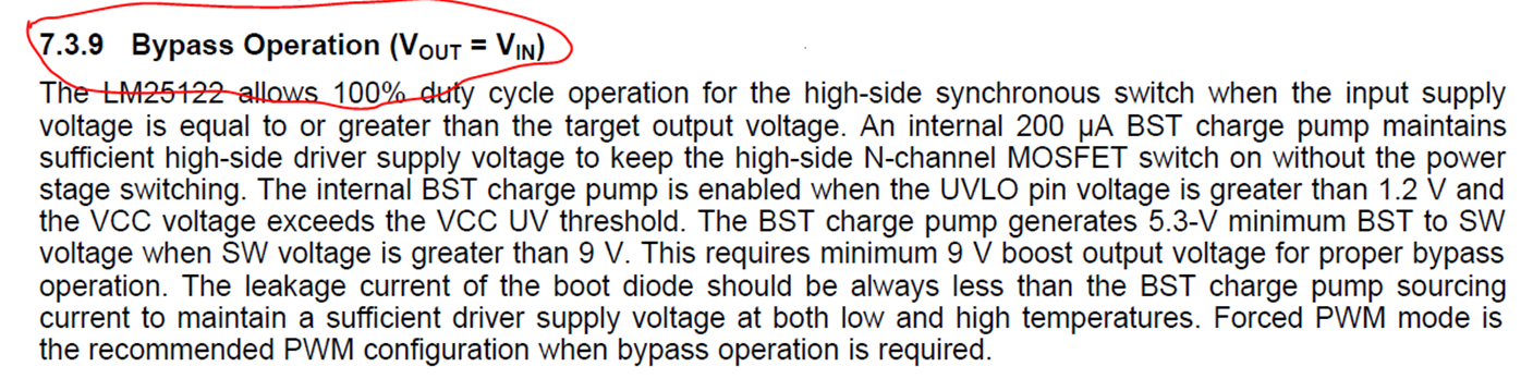

LM25122-Q1: How do we implement the BY-PASS function
Part Number: LM25122-Q1
Dear TI engineer,

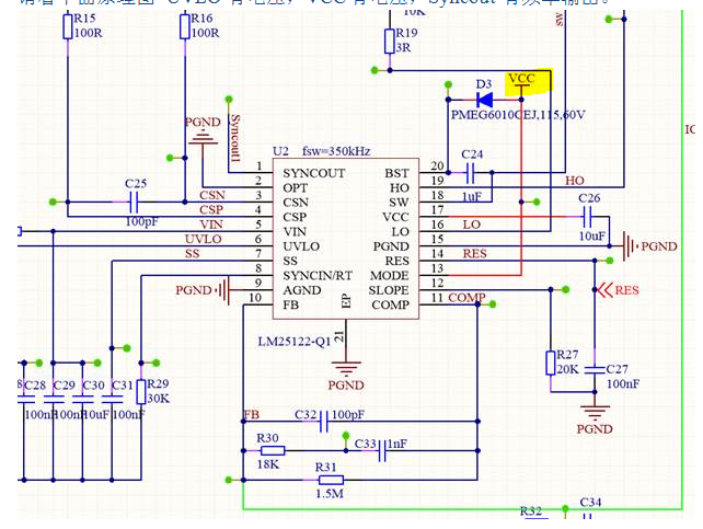

     My customer is meeting issue when using the by-pass operation, their condition is as below,
     Vout =12V, VIN= 13V, UVLO = 4.5V, according to below description, 100% duty cycle could be ok. But the function is not ok with customer's application ( Charging ).  Please help on this.
