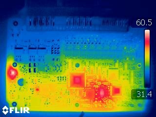

To fulfill the EMC CISPR25 class 5 requirements three of the LMR36015-Q1 DCDC regulators were desined in our ECU.
During our thermal inspection (IR camera, themal sensors) we determined that two of three regulator are running hot. Tcase is appox. 80°C and 77°C at 25°C amb! The input voltage is 28,5V; output voltages are 13V and 6V. The loads are amount 300mA. The third regulator has Vin 6V Vout 1,2V and is still cool at 300mA load. The regulator goes hot at voltage gaps (vin to vout) higher then 10V and at higher Vin.
The efficiency of the regulator is not the best but i think it isnt the problem. The package has no exposed pad! The thermal resistance junction to case (top) is 36K/W and no thermal conection to board bottom side. The TPS57140 regulator is regarding themal behaviour much better, but its not low-EMI related!
What is the problem? Any idea? Should I test it with the LMR36015AQRNXRQ1 400 kHz derivate?
Thanks in advance.
Eugen
