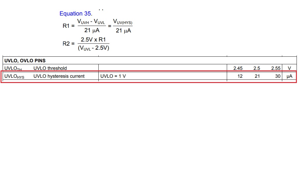

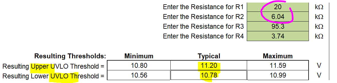

Dear Team,
hi , i will calculator UVLO voltage point, but i used equation 35.on the datasheet to calculate 11.4v, but the actual amount of 11.2v is measured,
is it must be to add the tolerance range of hysteresis current? or no need to increase the hysteresis current.
