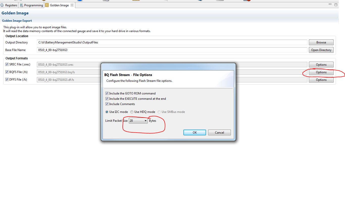

I am using BQ27510-G3. We will update firmware of FG through system update method. I found that there is one FG that can't be connected through I2C after system update method. I also tried to connect this FG using EV2400. But it is still fail. So I have few questions:
1,Does FG support to update using system?
2, If yes, what steps are needed to update? And is there any requirements for this process?
3,What reason will cause that FG can't be connected through I2C in update process?
4, Is there any fault log in FG to see what happens to FG?
5,If FG update unsuccessfully and can't be connected through I2C, could I update FW in system update method to make it work well again? Or could I update FW through EV2400 offline to make it work well again?
If FG update unsuccessfully and can be connected through I2C, could I update FW in system update method to make it work well again? Or could I update FW through EV2400 offline to make it work well again?

  • Hi
    -Looking at the files, i see that length of data in some rows is more than 32 bytes. Your host might not be handling the parsing on the gauge properly. You need to break up the bytes to be less than 30 bytes on each line using bqstudio during extraction. Bqstudio has the option of breaking up each row into smaller bytes when extracting the bqfs file. Click the options button in the window for extracting the bqfs and you will see the option for limiting the number of bytes
    -Secondly, you need to look at you signals on a scope to make sure you don't have too much capacitance on your lines and that could cause a 1 to look like a 0. Make sure you are not violating any of the i2c specs.
    -Furthermore, increase the time delays in your file from 2 to perharps 200. i.e the rows with X indicates the delay. you can see that most of them are 2ms. Increase that to 200.
    to address your questions above:
    1. Yes, the gauge allows updating in system. You have to absolutely make sure that there are no other devices active on the comm lines. I would strongly recommend powering down all the other devices on the comm lines when doing an
    in system update.
    2. See one above. Also, see attached app note. r.search.yahoo.com/.../RS=MZcP39je49aqNDJZpwhMkz9KcIE-
    3. See my first points listed above. Bad i2c signals, insufficient delays, having other i2c devices active on the comm lines. etc.
    4. There is no fault log. You could sniff the comm lines using an i2c analyser to see if there was NACK at anypoint during programming.
    5. You could attempt to program the default srec using bqstudio. If you are unable to communicate with the chip, then it is possible the chip is bricked.
    I hope this helps.
    thanks
    Onyx

  • 1. I do not understand what you mean by the "FG having to be Status".  When the FG is being updated, there should not be any communication with any other device on the comm lines occurring.
    2.
    I have captured what you need to do. See picture above. Select the limit package size to 20 as seen in the circled portion above.
    Chaning the time in the files has to be done manually by you. The portions  in the file that have X: 2 should be changed to X: 200. If you feel this time is too long, you can try 20 first to see if this provides better results.
