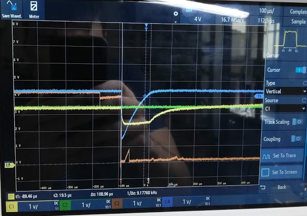

    In order for us to help debug, please provide a multichannel scopeshot showing Vin, Vout, Ven, and Iout. This will help us understand the relationship between the rails.
    We can do such measurements, but i'm not sure how to measure output current. At attached picture is Vin (blue), Vout(yellow), InRushcurrent Enable(Orange) - (it's a bit spikey, because i was using a wire shorting it to ground) and LDO enable(green). After this moment LDO goes into oscillation and can not be disabled. Maybe this graph is enough? Output current can be measured, but we also saw this with no load at the output, so i doubt this would be of any assistance. After LDO is disabled, LDO still has voltage on output, but voltage is dependant upon load, we have seen higher voltages also, up to 3.7V.
  • Hi Bart,
    I am glad to hear that you solved the voltage drop on Vin. The scopeshot you provided in your latest post confirms, that when the orange signal turns on, the inrush current on that rail is causing the shared input rail (blue) to drop. The LDO (yellow) is therefore forced into dropout until Vin rises again.
    The LDO output appears to be properly regulated whenever you only have the LDO enabled (the orange signal is in the disabled state). When the orange signal is in the enabled state, the LDO output always appears to be biased higher than 3.3 V. Traditional LDOs do not sink current. As such, when the LDO output is biased high, the LDO will simply disable the pass FET until the load can pull the output voltage back into regulation.

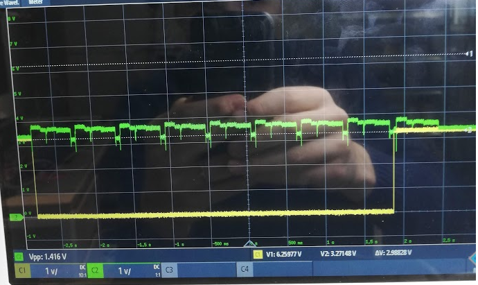

  • Hi Ryan,
    thank you for your feedback.
    • R1244 unpopulated as requested.
     Green - Ldo output, Yellow - LDO enable pin.
    Green ldo output, Yellow - LDO input voltage:
    2. R1244 and R20 unpopulated:
    Green - ldo output, Yellow - LDO enable signal. Ldo has 3.94V on output with no load, also when disabled. We have checked 2 devices.
    Looking forward for your feedback.
    Kind regards,
    TI Customer

  • Hi Bart,
    The LDO output being higher than its regulation voltage indicates that either a higher voltage rail is leaking onto the LDO output rail or that the LDO itself is damaged. The most telling scopeshot is your last scopeshot where you have isolated the LDO output from all other signals. As such, it appears that the LDO is damaged. This could be confirmed further by removing the LDO from the application altogether and placing it on an EVM such as MULTIPKGLDOEVM-823.
