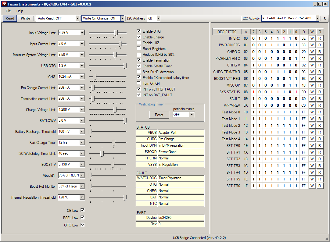

    Only the input qualification result differs, with JP2 shorted. (A functonal description of JP2 in the EVM user guide would be usefull.) In all cases VSYS stays off.
    I did look it more closely.
    On powerup from a DC source (lab supply), JP2 shorted, with a PMID load of 50ohm and a 5V-detector (w/ LED)  that adds 15mA when above 4.8V:
    • VSYS ramps up to about 1.0V in about 30µs, then stops and drops slowly.
    • The input current briefly shows about 90mA before rising to 115mA (== my load on PMID).
    • The voltage on PMID quickly (2ms) rises (C-charge curve) to 4.35V and stays there. After 272ms it rises to 5.00V.
    • With 50ohm plus an extra load of 12ohm on PMID the voltages are: 4.24V until t=272ms, 4.88V until t=422ms, 4.96V afterwards.
    • With 50ohm plus an extra load of 4.7ohm on PMID the voltages are: 4.16V until t=272ms, 4.76V until t=422ms, 4.88V afterwards.
    The event at t=272ms looks like an ideal-diode going ideal. The event at t=422ms disappears when JP2 is removed (open).
    This does not correspond with a 100mA nor 500mA current limit on PMID or I-in.

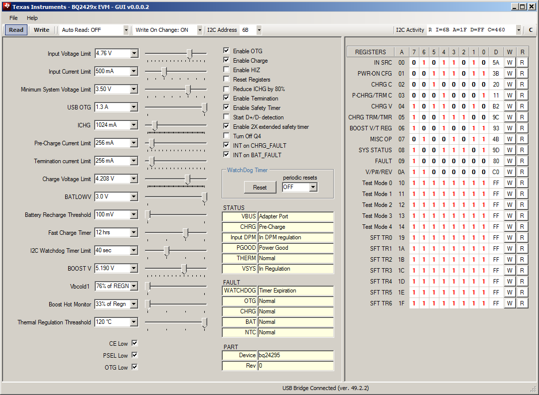

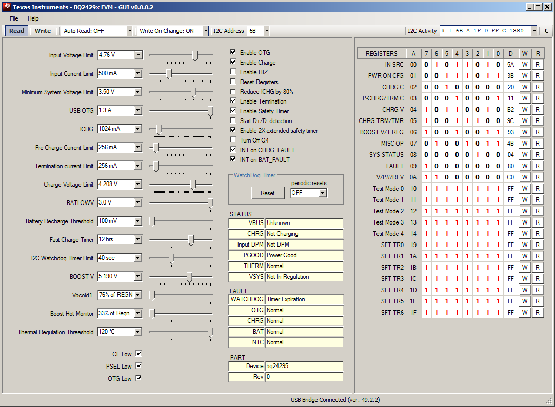

    At startup (default registers) the input current limit seems to be 500mA (readout immedately after applying power).
    At input qualification it should be 100mA.
    After input qualification it is 2A w/o JP2, and 3A w/ JP2.

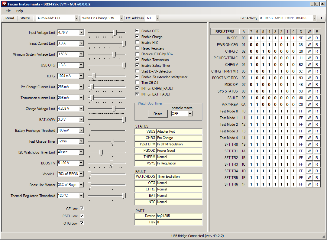

    Readouts:
    JP2-open - immediately after powerup :
    JP2-open - after Iin qualification:
    JP2-shorted - immediately after powerup :
    JP2-shorted - after Iin qualification:
    Please investigate.

    After input  (lab supply 5V/6A) qualification (t=420-430ms with JP2 shorted, t=840-850ms with JP2 open) , VSYS is switched ON again.
    VSYS rises to 1.65V, the input current to 98mA.
    The 100mA limit is not removeable from there on.
    IINLIM[2:0] does not indicate 100mA. "In DPM regulation"-flag is set properly. Didnt notice that.
    Reset, watchdog, changing Ilim, Q4, restarting D+/D- detection, nothing will remove the 100mA limit.
    With other loads, the problem differs. What stays is the 100mA input current limit, when tripped in the startup logic.

    Referring to page 8 of the d/s, the input limit is set to 100mA when VSYS is below 2.2V.
    BQ2589x has similar spec. Please refer to https://e2e.ti.com/support/power-management/f/196/t/777459 for more details.
