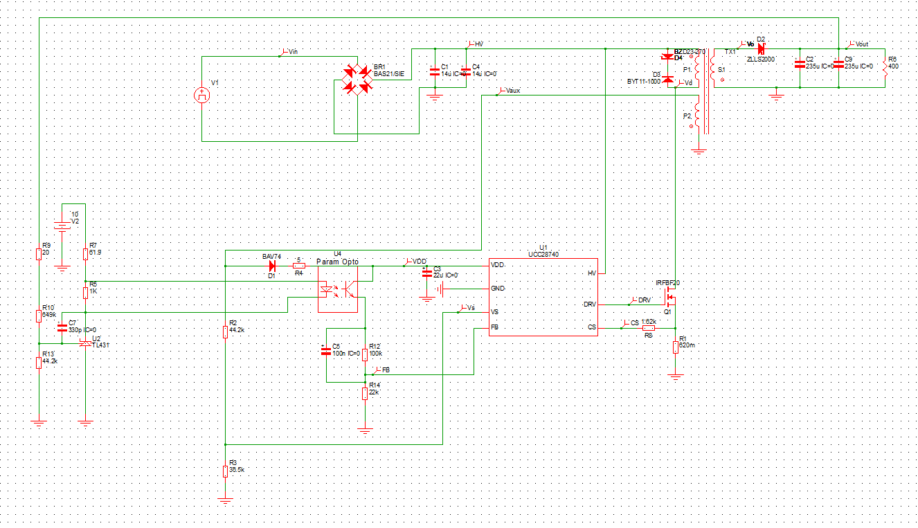

I'm designing a power supply using ucc28740 so I'm using the UCC28740_TRANS_SIMPLIS example circuit file of with 200V input and 5V @ 2A output. I'm facing an issue if I copy UCC28740 and paste in a new simplis schematic than I face the following error.

On the other hand if I edit the attached example circuit to use ucc28740 to design my own switch mode power supply to get 230V input and 40V @ 1.2 A output to design my required switch mode power supply than the circuit is not working. It is also mentioned in the example circuit of simplis that

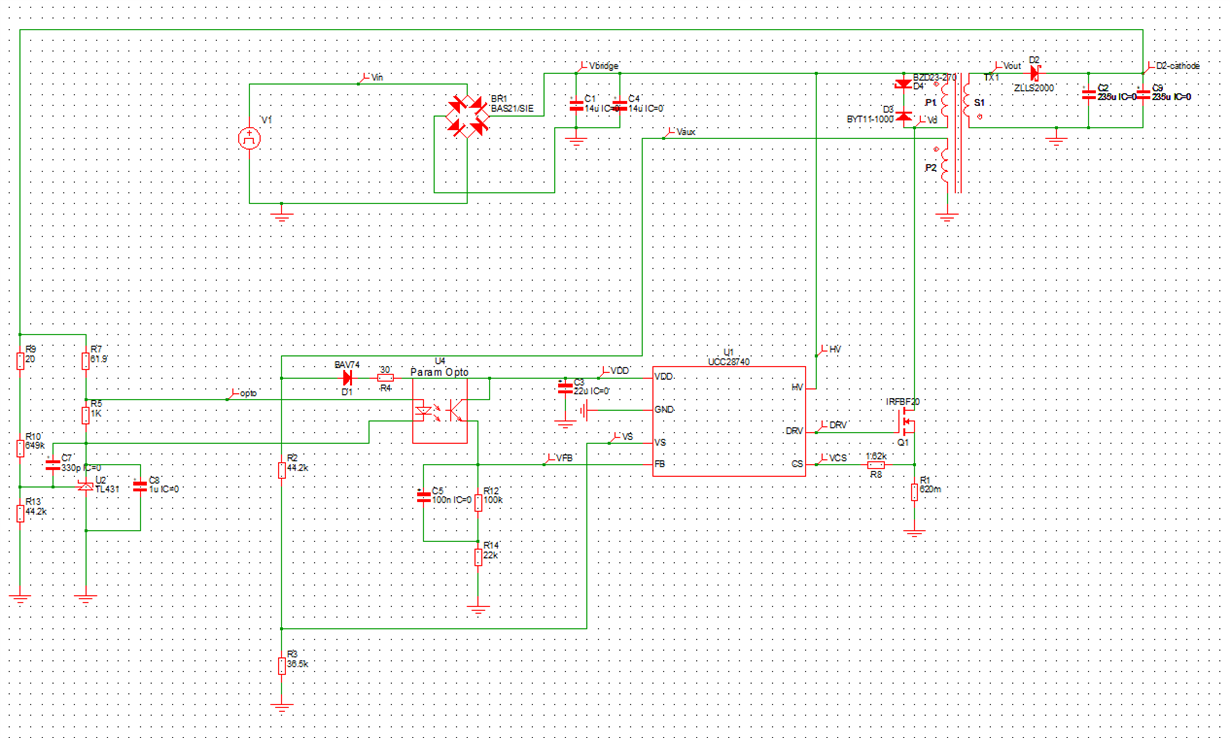

    I'm sending you my file so I can get your help . When I increase time limit than I face the following error .

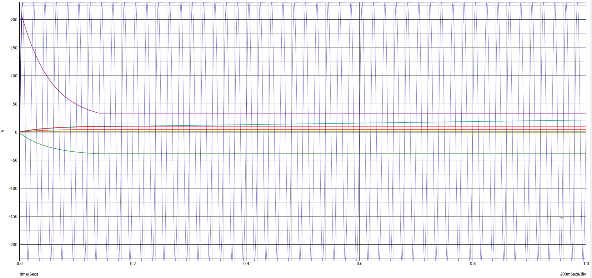

    But when I decrease my time upto 1 second than it run but no voltages appear at the DRV pin

    From your posting of the system-level model today, I do see 2 major errors and a few minor issues with your circuit:
    1. You cannot have the AC source grounded to the primary-side ground. This will short-out one of the diodes in the bridge and result in a short-circuit every other half-cycle. In a real system this would blow the protection fuse. In this simulation, you'll get half-wave rectification and huge current peaks out of the V1 source.
    => Please remove the GND symbol from the bottom of the V1 source.
    2. The polarity of the primary-Auxiliary winding is backwards.
    => Connect the dotted-end to GND and the non-dotted end to Vaux.
    3. Reconnect the VFB net to the top of R14, not at the top of R12.
    4. Disconnect the "soft-start" cap C8 from across the TL431. In real life it may help reduce output over-shoot, but in the simulation, it will just slow everything down too much just to get started.
    5. Your output voltage is ~40V. I think the TL431 model does not operate that high and may be clamping at start-up and conducting through the opto-coupler when the opto should be off. For simulation purposes, place a 10V source next to the TL431 and connect R7 to that source instead of to your Vout net. Keep R9 connected to Vout.
    6. 30ohms for R4 (in VDD circuit) may be a bit high. Please reduce the value of R4 to 5ohms for now, then change it later as needed to optimize after your system works.
    7. Consider to add some load to Vout, say 40V/0.1A = 400ohm resistor across the output.
    Hopefully with these changes you'll be able to get some switching signal out of the DRV output.
    I still can't help you with the error messages, but I'm hoping that the Sim-group will be in contact with you very soon.
    Ulrich

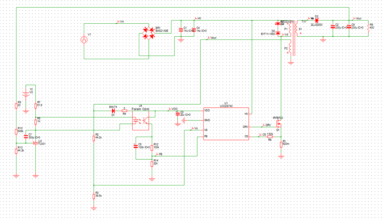

  • Hi Ulrich,
    First of all thank you so much for helping me out .I followed your instruction and did the required changes in the circuit than I get the attached file results.

  • Hi Ulrich,
    First of all thank you so much for helping me out .I followed your instructions and did the required changes in the circuit than I get the attached file results.

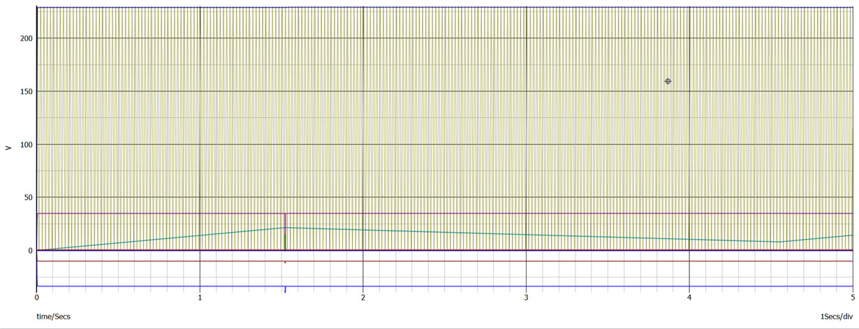

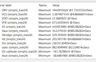

    The latest run shows that the IC is attempting to switch at the ~1.5s point of the run, but some condition is out of spec so the controller goes into a UVLO-cycle shut down and tries to restart. You can see this by VDD rising to ~21V, you get a switching, then VDD decays down to ~8V and starts rising again. The IC is working as designed, but some circuit condition is not right for sustained operation.
    I am concerned that the drain voltage ta "Vd" is flat at ~35V even thought HV = ~230V. The D3-D4 clamp looks okay.
    Can you list the parameters that you are using for the transformer TX1, please?
