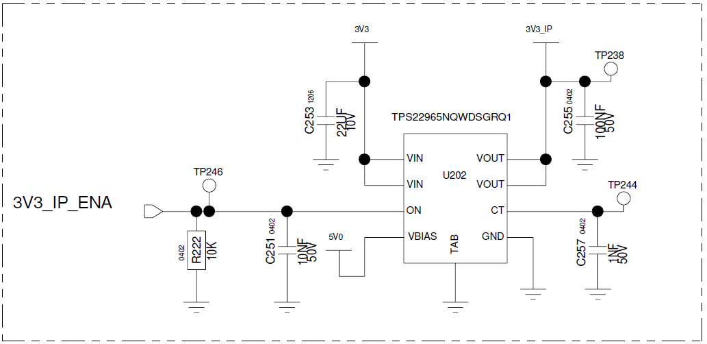

    [1] The operating conditions are listed below for your reference :
    • Input Voltage = 3.3V
    • VBIAS voltage = 5V
    • On Control (3V3_IP_EN) = Driven as high from micro controller (LVCMOS 3.3V level) -as a default grounded with 10K resistor.
    • CT pin = grounded with 1nF capacitor
    Attached schematic for your easy understanding.

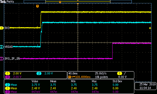

    [2] Timing restrictions:
    VIN voltage generated first, BIAS voltage will be generated second. After the proper settling of both the power rails, ON signal will be released from micro controller.

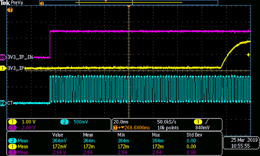

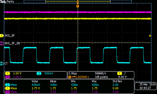

    RESULTS OF MEASUREMENT :
    1. VIN ramps properly and settled at correct voltage level.
    2. VBIAS also ramps properly and settled at correct voltage level.
    3. ON control also driven as high from micro controller after the validation of input voltage rail.
    4. But, upon the assertion of ON control signal, CT voltage is pulsating and VOUT also not observed at output.
    Attached the snaps for your understanding.

    At first glance, it seems unusual that VOUT isn't rising on the output. Even with the configuration you described with EN waiting until VBIAS and 3V3 are present, the device should operate normally.
    1: What is your downstream load? Can you replicate the same test with your downstream load disconnected?
    2: It also looks like the CT pin is being pulled down by something, is there a short to GND on the CT pin or is your oscilloscope probe pulling the pin to GND? Normally, it doesn't oscillate in the behavior you've observed.
    3: What is 3V3_IP? Is this the output voltage?

  • Hi Devendhiran,
    Thanks for the additional clarification. If possible, I recommend testing the IC again without the SoC attached to see if you can replicate the behavior. If the downstream SoC is in a UVLO or undervoltage state, this could be potentially causing the CT cycling as the SoC repeatedly tries to turn on.
