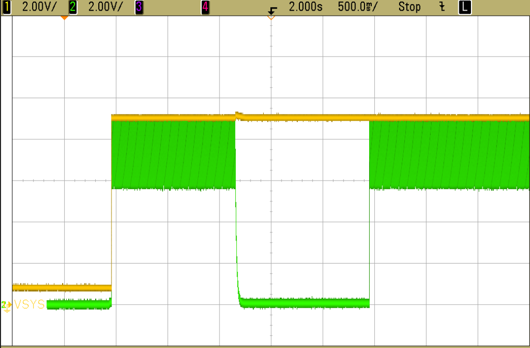

Now I USE I2C driver the BQ24773 has a problem. When I  not connect the battery, I only provide the adapter power supply. After MCU sends disabled charging function data (ChargeOption0() sends 0x67CF), the power output of the whole system is turned off? how to Solve the problem?

    Thanks for the clarification. I just tested this on an EVM and got similar results for #2. However, for #1 (no battery connected), VSYS should be set by your maximum charge voltage register. This is true whether charging is enabled or disabled.
    One possible reason that your VSYS falls to 0 V is if the charger enters SYSOVP (see Section 8.3.10.4 in the datasheet for more details). SYSOVP causes ACFET and RBFET to latch off, so with no battery connected, VSYS will fall to 0 V. I was able to get VSYS to fall to 0 V on the EVM if I entered SYSOVP.
    To confirm whether or not SYSOVP is the issue, please check bit [11] in register ChargeOption0 right after VSYS falls to 0 V. Also, please double check your CELL pin configuration, as this sets the SYSOVP threshold. Is the CELL pin pulled low, floating, or pulled high?
    To answer your last question, here's a waveform showing the behavior with no battery and no system connected. Yellow is VSYS and green is VBAT. When I plug in the 19 V adapter, VSYS rises up to my max charge voltage register setting (9 V), and VBAT oscillates as the BQ24773 performs float charging and continuously enters charge/recharge cycles. I then disabled charging, which caused VBAT to fall to 0 V while VSYS was still regulated to 9 V. Finally, I enabled charging again, and float charging resumes.
