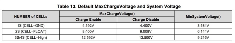

1. what is the significance/function of learn mode in the IC.
2. when learn mode is enabled, the battery discharges completely but it does not start to charge once it is depleted below threshold. should the adapter be reconnected in order to charge the battery.

    Q1: In general, the learn mode purpose is for gauge calibration and then it should be more accuracy in checking battery capacity dropping and its life cycle . The learn mode is requested by lap top application
    Q2: when learn mode enable, the battery will discharge until battery voltage is lower than min system voltage. Then BQ24773 will enable charge again. Battery won't discharge completely. please check below table to know default value MinSystemVoltage data.
