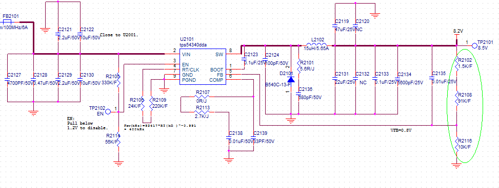

Figure 1 shamatic

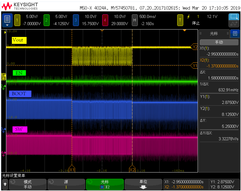

Figure 2 output voltage

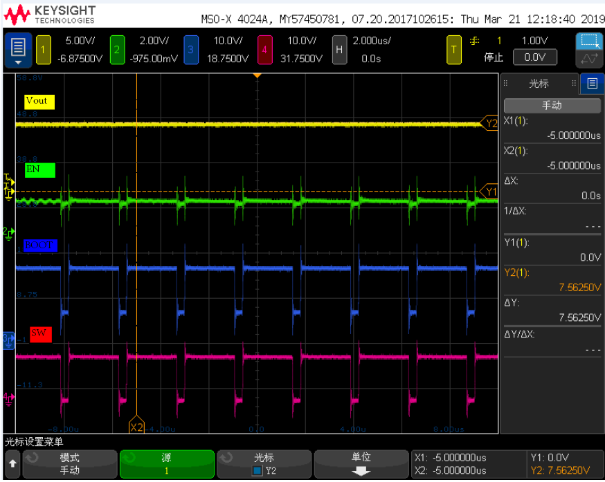

Figure 3 waveform at ripple, green EN, blue: boost, red SW

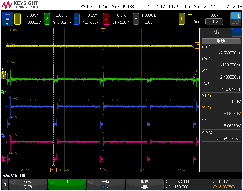

Figure 4 waveform after ripple stop, yellow output, green EN, blue: boost, red SW
