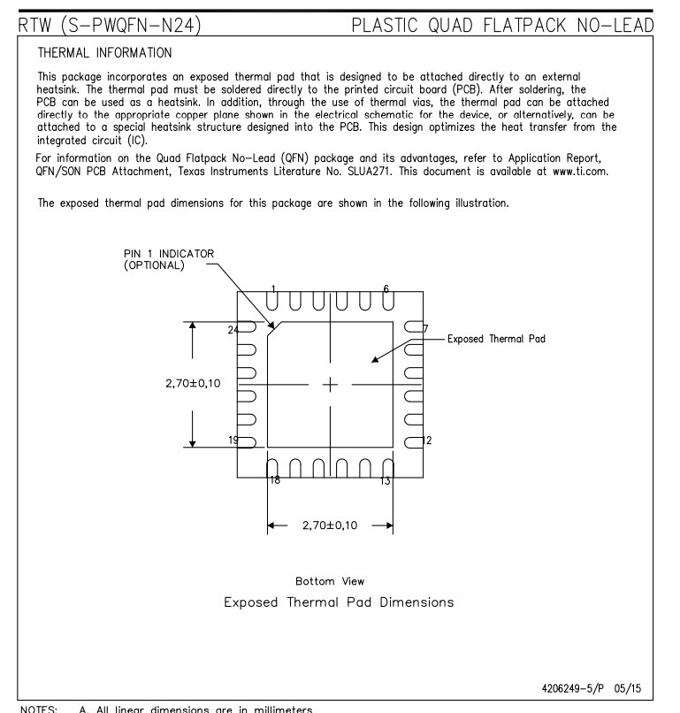

I'm unable to find what the dimension for the thermal pad of the bq25895 is.
Datasheet says " thermal pad size and shape shown on seperate sheet"
http://www.ti.com/lit/ml/mpqf167b/mpqf167b.pdf
but there ain't any
