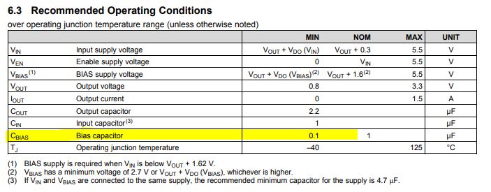

Dears
The minimum CPA for Vbias is 1uF in SPEC of TPS74801.
However,the CAP in our design is 0.1uF for Vbias pin.
is there any concern for Cbias 0.1uF?
The attached file is the ripple of Vbias.
Please help to feedback.

Hi Kevin,
TPS74801 is designed, tested, and characterized for operation with a minimum Bias capacitor of 0.1 uF. As such, you are within our Recommended Operating Conditions.
A 1 uF capacitor is recommend on Bias in order to provide additional stability to the rail for optimal performance.
