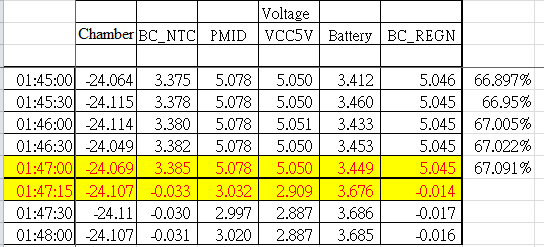

Our customer test "Battery discharge test"  in chamber(-25 degree C) find that IC reach for NTC protection early.
The test table as below,
*We find the VREGN=0V @ 67%.
After this test, I ask for customer use  10K Variable resistance to test then find the NTC protection is 76% and 36% normally.
First, I doubt the battery can't work at -25 degree C lead to VREGN no output. But the PMIC still have voltage (2.997V). So MAYBE battery is normally.
Now Customer want to us to explain "what conditions will lead to Q4 be turned off when battery discharge"
I study the conditions and arrange it as below,
1. Battery voltage under 2.0V
2. NTC protection
Did I miss others conditions?

  • Hi Ning,
    Thanks to your reply. I have another question.
    I study the REGN enable conditions,
    The REGN is enabled when all the conditions are valid.
    1. VBUS above VVBUS_UVLOZ
    2. VBUS above VBAT + VSLEEPZ in buck mode or VBUS below VBAT + VSLEEP in boost mode
    3. After typical 220-ms delay (100 ms minimum) is complete
    So in boost mode, VBUS need to above VVBUS_UVLOZ-and below VBAT+VSLEEP ?? BUT VBUS no output when boost mode. (Use Battery supplied)
    BTW, when use Battery supply, does PMID supply to LDO then convert to VREGN?
    1) In boost mode, the condition 2 is "VBUS below VBAT + VSLEEP in boost mode".
    2) REGN ramps up before the device starts switching to support PMID voltage.
    Ning.
