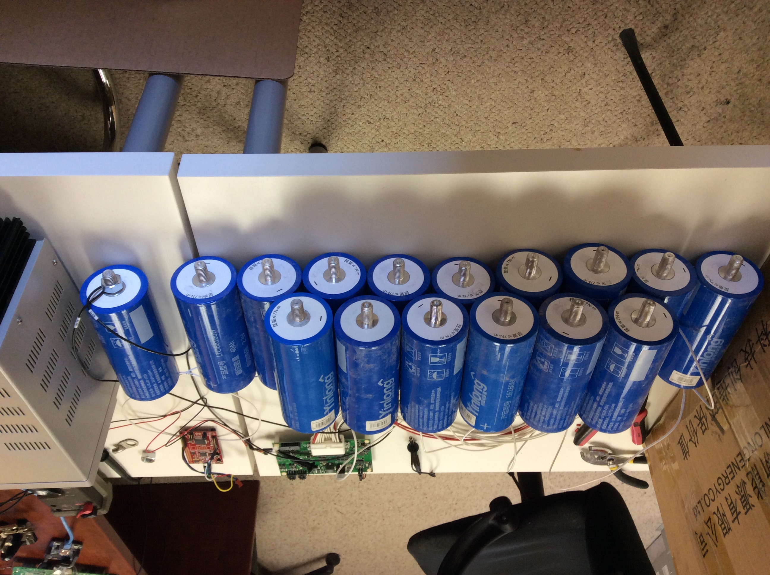

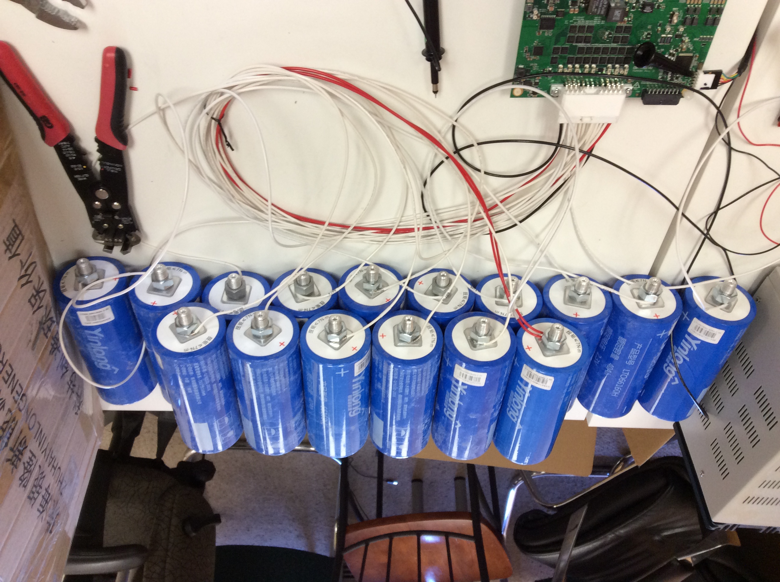

i want to develop a battery harness for the wires supplied with the connector J1 on the evaluation module. If I refer to the document SNOU143, Table 2, it states:
PIN 18, BAT1, "Positive Terminal BAT1, negative terminal BAT2.
Does this mean the wire labelled BAT1 (from the supplied connector with the evaluation kit) needs to be split with one end going to the Positive terminal on BAT 1 and the other end going to negative terminal of BAT2.
Do you have a wiring diagram available?
Malcolm
OK. However, I think I am getting the configuration.
A couple of other questions:
There are two BAT0's. They both go to the negative terminal of battery 1?
There are two wires labelled BAT16 and BAT16S. These both go to the positive terminal of battery 16?
Thanks for your help.
Malcolm
