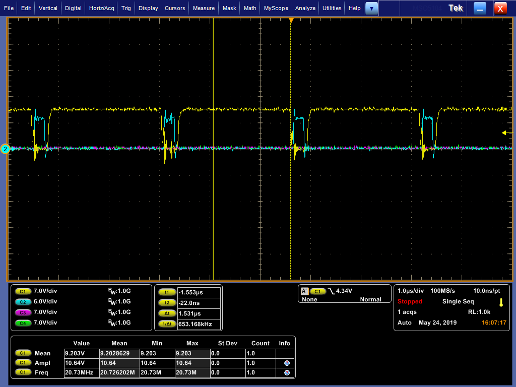

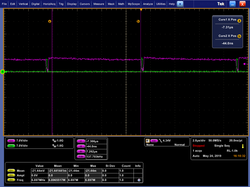

    Finally we have assembled a new board and still have the same problem. I did your changes as well.
    I will summarize what i saw like this:
    *I put 1R instead of bead and when i turned power on everytime this resistor blown-up. Every time i changed it and restarted to test.
    **I looked at PCB with thermal camera and everytime LM5176, D5 and of cource the mentioned 1R resistor were like hell.
    ***I know it makes no sense but still i took  the scope snapshots of gate waveform as attached. Yellow-buck top gate, Blue-buck bottom gate, Purple-boost top gate, Green-boost bottom gate. The strange thing i think is that when initially startup it should work in buck mode so Boost top Fet should be fully on and bottom Fet should be fully off, am i right?
    It seems it is impossible to test and make measurement without burning something out. What is your recommendations?
    Shall i pass one another Buck&Boost chip, i do not have too much time.
  • Hi Ihan,
    D5 should have a higher current rating, please try a diode with a 1A current rating. This diode provides a high peak currents to charge the boot capacitor with current. Please try this first.
    What is the power rating of the 1ohm resistor on the output?
    When start-up is happening is the output voltage pre-biased with a voltage?
    Another IC suggestion is the LM5175 that is DCM capable. It is pin to pin compatible with the LM5176, however the RT/SYNC pin resistor will need to be modified per the datasheet to match the desired switching frequency.
