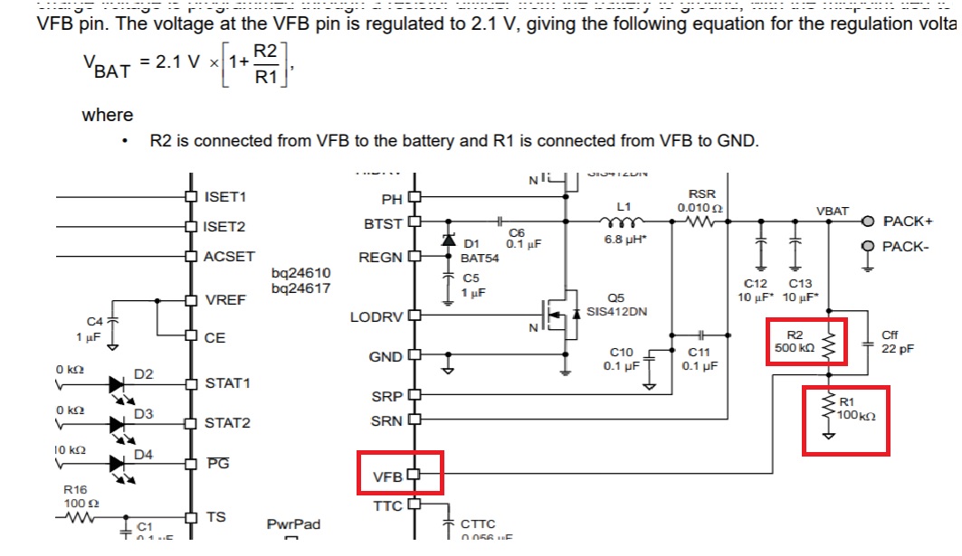

My customer use BQ24617 to charger 4.2V battery(1cell). currently want use to charger 4V Battery.
May BQ24617 can charger 4V Battery? if we just need to change Vfb?
