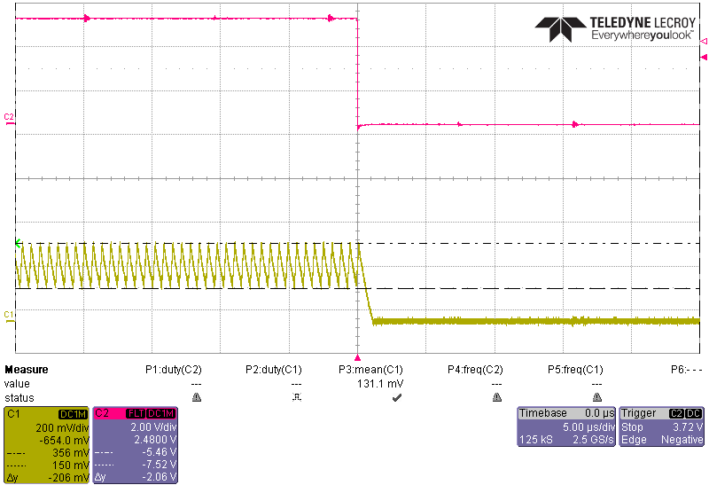

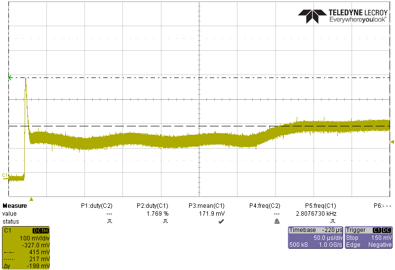

     I am noticing a significant spike when ever PWM pin is enabled from the disabled state as shown below in figure 1 at upper input voltages around 30vdc. Web bench does not show this anomaly when simulating PWM however the PWM is much faster in the simulation. Web bench does show a similar spike in simulation ( figure 6) for the startup conditions which occurs while the comp capacitor charges but this spike is much smaller in than I measure in the simulation. If I calculate the value of Ipeak which can occur at start up I get 2.8A @ 30v, which is also lower than I am measuring in figure 2. As seen in figure 1 Vcomp is dis-charged so this would make sense that the system is going into minimum pulse width mode. Note the on time during the spike is larger than the on time in normal operation in figure 3 & figure 4. I would have expected it to be = Ton min 140nS.  It seems to be worse when Vcomp only partially discharges than when it fully discharges. Any thoughts on why that may be or how to resolve the issue?
Figure 1:  Yellow: Short Current spike measured across a 0.2 ohm resistor. Pink: Vcomp pin

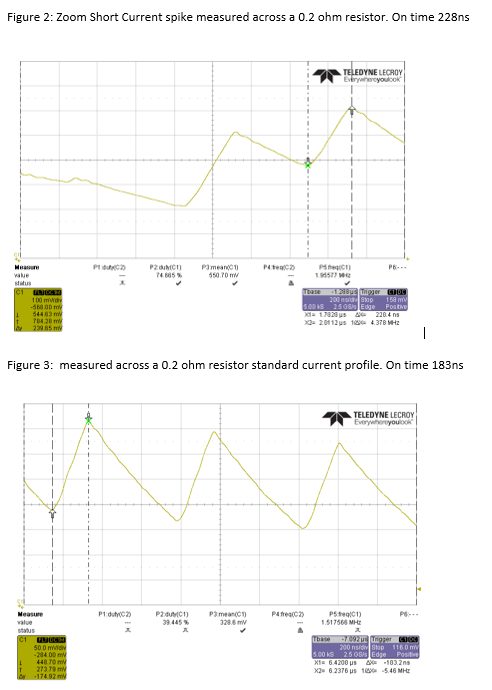

Figure 2: Zoom Short Current spike measured across a 0.2 ohm resistor. On time 228ns
Figure 3:  measured across a 0.2 ohm resistor standard current profile. On time 183ns
Figure 4:  standard current profile measured across a 0.2 ohm resistor

    Can you measure Vout when PWM first goes high along with the current? If the compensation remains unchanged but the output voltage drops during the PWM off-time you can see a current overshoot until Vout gets back to where it is supposed to be because of C13. If this is due to C13 charging the LEDs will not see this current, can you also measure the LED current?
    Also note that the minimum on-time of 140 ns is typical.
  • Below:  I led measured across a 0.41 ohm resistor note there are 3 parallel paths so total current is 3 times this reading.
    Above: yellow V out, Pink: pin 4 Pdim
    Below: Yellow I out at off transition,  Pink:4 Pdim
    Below: Yellow: I out, Pink pin 8 Vcomp
    Below: Yellow: I out, Pink pin 8 Vcomp  Zoomed out

    What is Q1 for? What is FB4?
    It appears to be minimum oscilloscope picture with COMP. The other I would look closer at COMP during the running and off-time. You can try lowering the switching frequency to see if that changes the overshoot. You can also try a different COMP capacitor value to see if there is change in behavior.

    There are two currents that are involved when turning on. One is the LED current the other is the current to charge the output capacitors. There will be overshoot if Vout is lower then when it was turned off because comp stays constant. This current is going to charge the output capacitor. Comp will also try to compensate for lack of current when it first turns on which can cause overshoot. I'm not sure if you checked but when you changed the comp capacitor did the overshoot change (amplitude and duration)? It should be less overshoot with a larger capacitor but for a longer duration. Also, watch Vin when this happens. If it is drooping when it is switching and you have a input capacitance you can also get overshoot because Comp will not be at the right level for a higher Vin when it initially starts. The Comp hold assumes that Vin and Vout stay the same from turn off to turn on. I would look at trying to increase C13 value so if there is overshoot it goes into the output capacitor. There are other possibilities as well.
  • Below you can see light yellow with standard Ccomp 10nF.  Dark yellow is with Ccomp set to 1uF.  the spike goes up a bit but duration is about the same.
    Changing C13 to 11uF there is only a 1.86A spike on the LEDs.  However the inrush spike over all in the system increases to 6 amps due to the increased current to charge C13.  I would need to increase my current sense resistor power, it's also a larger EMI spike.
    Changing C13 to 2.2uF  brings spike on the LEDs to 3.15A. The inrush spike over all in the system increases to 4.26 amps due to the increased current to charge C13.

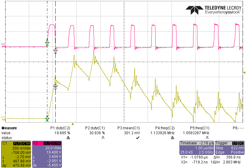

    i used a 4 channel scope to get all the readings at once. the results are not as clear so if you want a zoom of something let me know.
    On all grabs,
    Channel 1: Vin
    Channel 2: Vout
    Channel 3: Vcomp
    Channel 4: I out
    Images are in the order: Pwm on until current V comp stabilizes.
                  Zoom: PWM turning off
         Zoom pwm turning on.

    This looks like initial turn-on which could be minimum on-time caused. I was more concerned about when you are PWM dimming and Vout is not low. If comp is low and the current peaks as it is doing, unless something else is going on, it is probably minimum on-time. If lowering Vin or the switching frequency helps it points to this as well. You can also look at the switch node when this is happening. It should not be regulating current as comp rises and it looks like it is (at a lower level than the set-point), what does the switch node look like during this period.
    Can you look at this during the PWM off/on pulse?
    I would try decreasing the switching frequency (possibly with a larger inductor value). It seems the frequency is too high for the duty cycle you are trying to operate at.
  •                 It could be too high of a frequency but it’s what the TI Simulation tool recommended, at 32v it’s right around the minimum on time but even at 28v where there is more  wiggle room the spike is still there.  If I use a 10uH inductor and set the frequency down to 1 Mhz the spike is right around the same height as the standard current wave which unless i am missing somthign else seems to solve the issue.  I will have to find a way to fit that bigger inductor.
    Images below in order
    1. Pink Current, yellow Switch node.  ( PWM low to high) Note the extended on time on the first few cycles.
    2. Pink Current, yellow Switch node.  ( PWM high to low )
    3. Pink Current, yellow Vcomp.  ( PWM low to high)
    4. Pink Current, yellow Vcomp.  ( PWM high to low )
