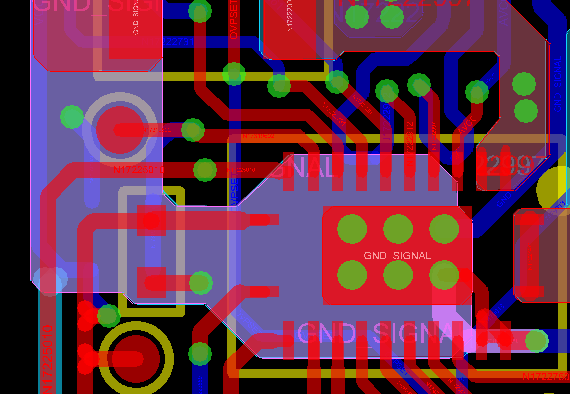

  • Regarding 1,We already provided the Ground plane in 3 layers,And patch them with the via.So proper grounding is also provided.
    I am attaching you image of the layout.Please see.

  • Hi Tirthal,
    Smaller internal ground planes, like the one shown above, don't provide much heat sinking. Is one of the ground layers the bottom layer?

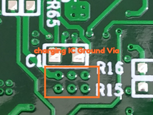

    We have not kept the ground plane in the bottom layer but we have patch with via.
    Thing i want to share with you is that , in our PCB we have filled the via with the masking.So can this be the heat dissipation issue...?
    I am attaching the PCB Image so please check.

  • Tirthal,
    The masking is preventing the IC powerpad from being soldered to the vias. This is likely the problem. I suggest scraping off the mask with a knife and resoldering the IC.
    Jeff

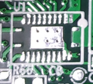

  • Dear,Jeff
    The image that we provided previously was of the bottom side.I am attaching you top view of the PCB.
    Kindly find the image.
    Suggest any solution...!!
  • Tirthal,
    The bottom vias do not appear to be solder to the ground plane for heat sinking. The powerpad must be soldered to a ground plane that is significantly larger than the pad itself for proper heat sinking.
