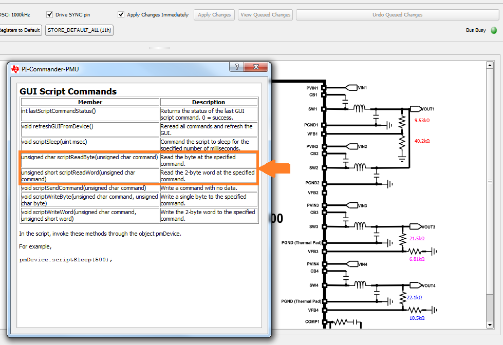

    I also want to create the scripts, creating sequences to change values on the registers of the TPS65400, for example changing Vref by using scripts commands. Is this possible? If it is possible, what is the syntax of those commands?

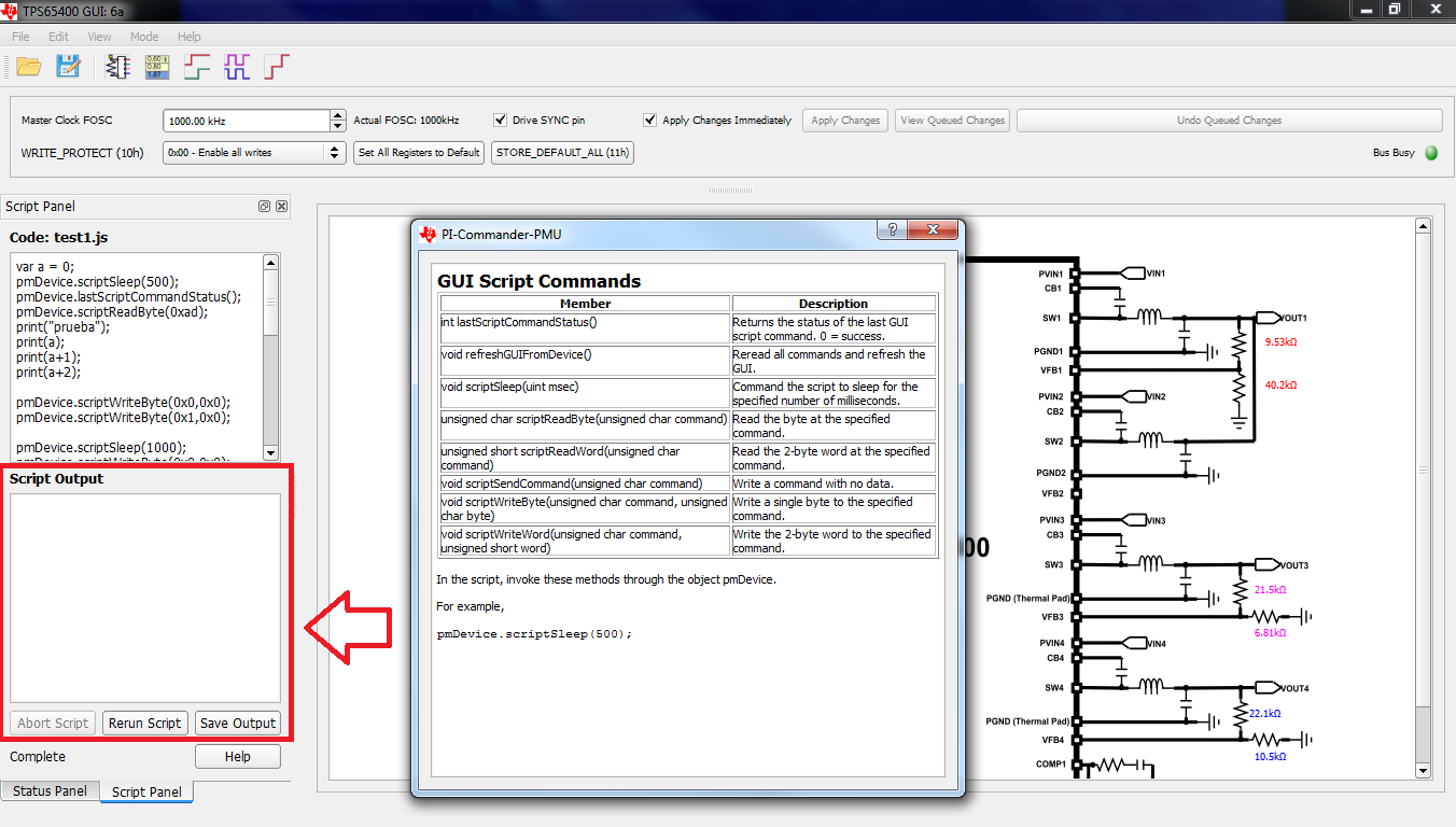

  • I was able to create a basic script to change VREF and therefore VOUT, but when I try to read the value of a register I cannot see any result in the Script output of the GUI, please also provide a method/command to visualize the register values of the TPS65400 using scripts in the GUI.

    Also please check the image attached, how can I get results directly in the script output? I have tried the read commands and I get nothing.
    For example, how do get the value of (ADh IC_DEVICE_ID) using the XML file and the script output?

  • Hi Hao;
    Thanks for your response.
    I have a question.
    Then where/how do I get the result of the "read" commands?
    Regards;

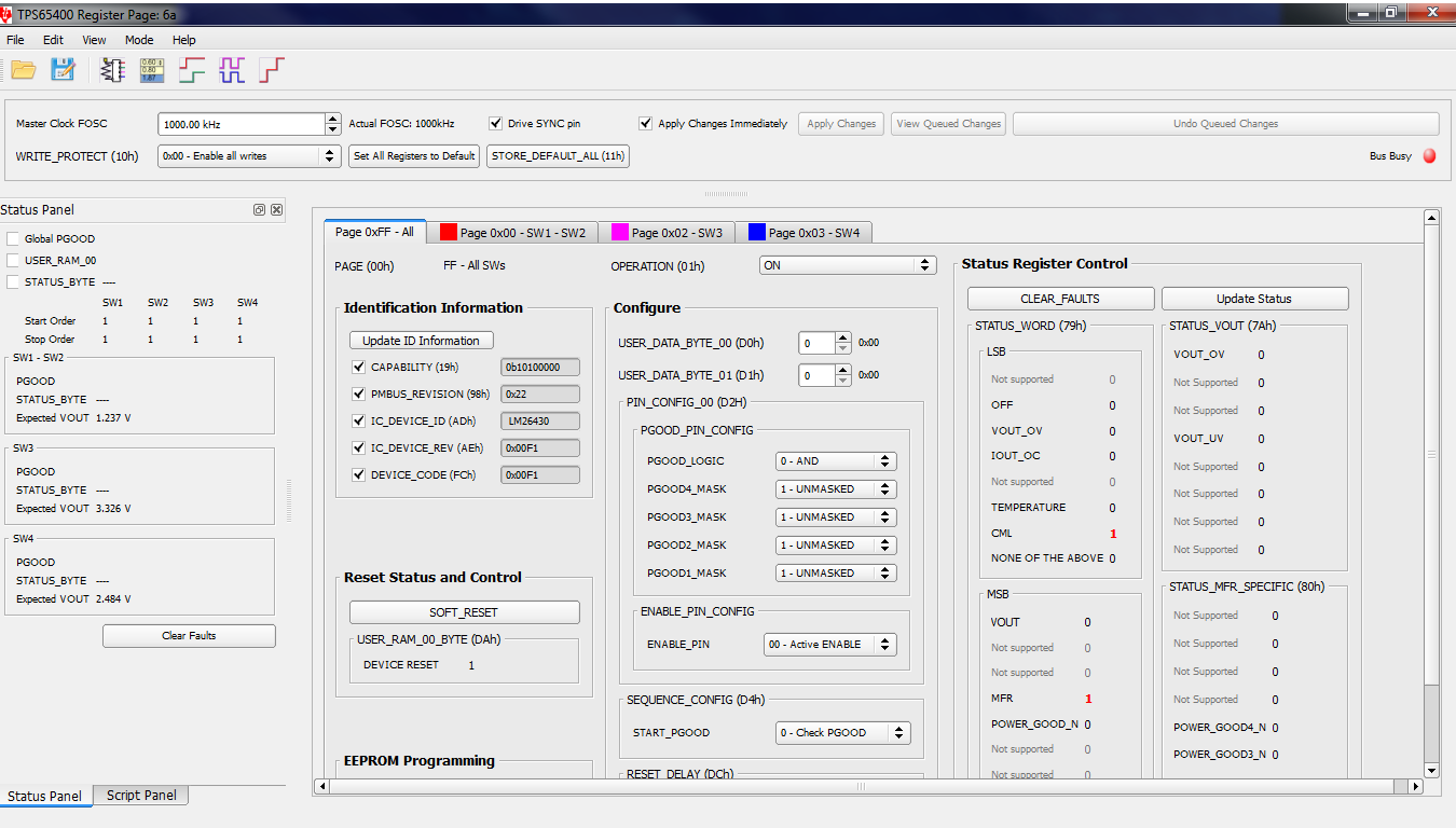

  • Hi Luis,
    The results should be show up in the "PMBus register page".
    Hao
  • Hi Hao;
    What do you mean by "PMBus register page"? Is that pages shown in the GUI in the picture below?
    I would expect a reply from the command like another byte or word when I use the read command , is it possible?
    My intention is to run a script and obtain on the fly readings from the TPS65400, readings from the status registers and other registers if possible, can this be done?
    Regards;
    Luis
  • Hi Luis,
    Yes, I mean this page. I think the script is a sequence of writing command. This GUI doesn't support to read and save the register vaules...
    Hao
