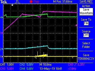

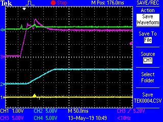

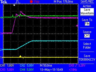

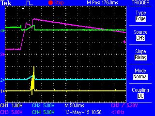

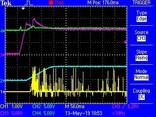

  • Hi Ulrich,
    We've capture some waveforms during startup.
    Cap1 - No load; Ch1=CS, Ch2=SS, Ch3=VCC, Ch4=Comp
    Cap2 - 200 ohm load; Ch1=CS, Ch2=SS, Ch3=VCC, Ch4=Comp
    Cap3 - No Load; Ch1=QR, Ch2=SS, Ch3=VCC, Ch4=Comp
    Cap4 - 200 ohm load; Ch1=QR, Ch2=SS, Ch3=VCC, Ch4=Comp
    Any thoughts?

    The captures where taken from a cold start. Cap 1&3 had no load and the unit came up normally
    Caps 2&4 had a 200 ohm load connected and did not come up.
  • Hi Don,
    Alright, in all 4 start-ups, the VDD gets very close to 15V before either topping off or shutting off. From the 200mA start-up attempts, COMP is pulled to GND compared to the no-loads, where COMP settles to 1V or something. Based on the turns ratios, I get Na:Ns = ~1: 0.13, so for 90V out, it would be ~11.74 V at the Aux winding.
    The QR input OVP threshold is 3V, and with 5.11K and 18.7K work out to OVP = 14V at the Aux winding.
    Since VDD looks like it's hitting 15V, I surmise that QR is exceeding the 3-V OVP threshold during start-up.
    It may barely make it past this with no-load, but I think the higher load currents set off the OVP shutdown.
