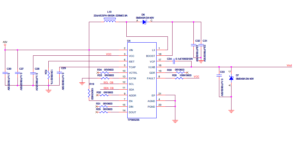

    MAy you pls help check enclosed file circuit.
    Do we Vctrl can floating when we work in I2C mode?
                                                            Bogey
  • Hi, Sir
    Some comments for schematic:
    1. Suggest to change C30 to 10uF.
    2. Change C28 to 1uF.
    3. Change R24 to 220kohm.
    4. Connect VCTRL pin to GND or floating.
    5. Connect EN pin to GND directly.
    6. DIN, DOUT, GDR pin can be floating.
    7. Change L10 to 10uH.
