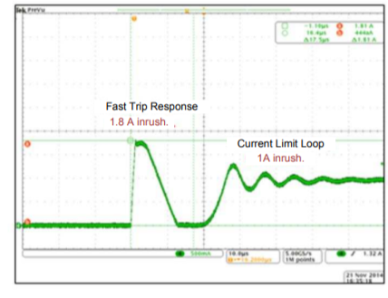

  • Yamaguchi-
    If there is a short to GND where the current limit exceeds 1.5x the current limit, the device will trip off in <1us as seen in the below waveform:
    As you can see, this response works extremely fast to turn off the device, and then after a short period it turns back on into the current regulation mode
    Alec
  • Hi Alec-san,
    Thank you for the answer.
    The waveform you sent is low resolution, so if you have better resolution waveform, could you send me it?  Is the horizontal axis 100us/div?
    I indicated the "fast trip response time" with red line in the waveform below. Is my understanding correct?  Is it possible to indicate the current limit response time 10us you mentioned in this waveform?
    /cfs-file/__key/communityserver-discussions-components-files/196/TPS4H000_2D00_Q1-Short-mode.pptx
    Yamaguchi
  • Yamaguchi-san,
    That image is figure 19 from this document: www.ti.com/.../slva859b.pdf. The horizontal scale is 10us, so yes the timing you have indicated is correct and is about <1us.
    Alec
