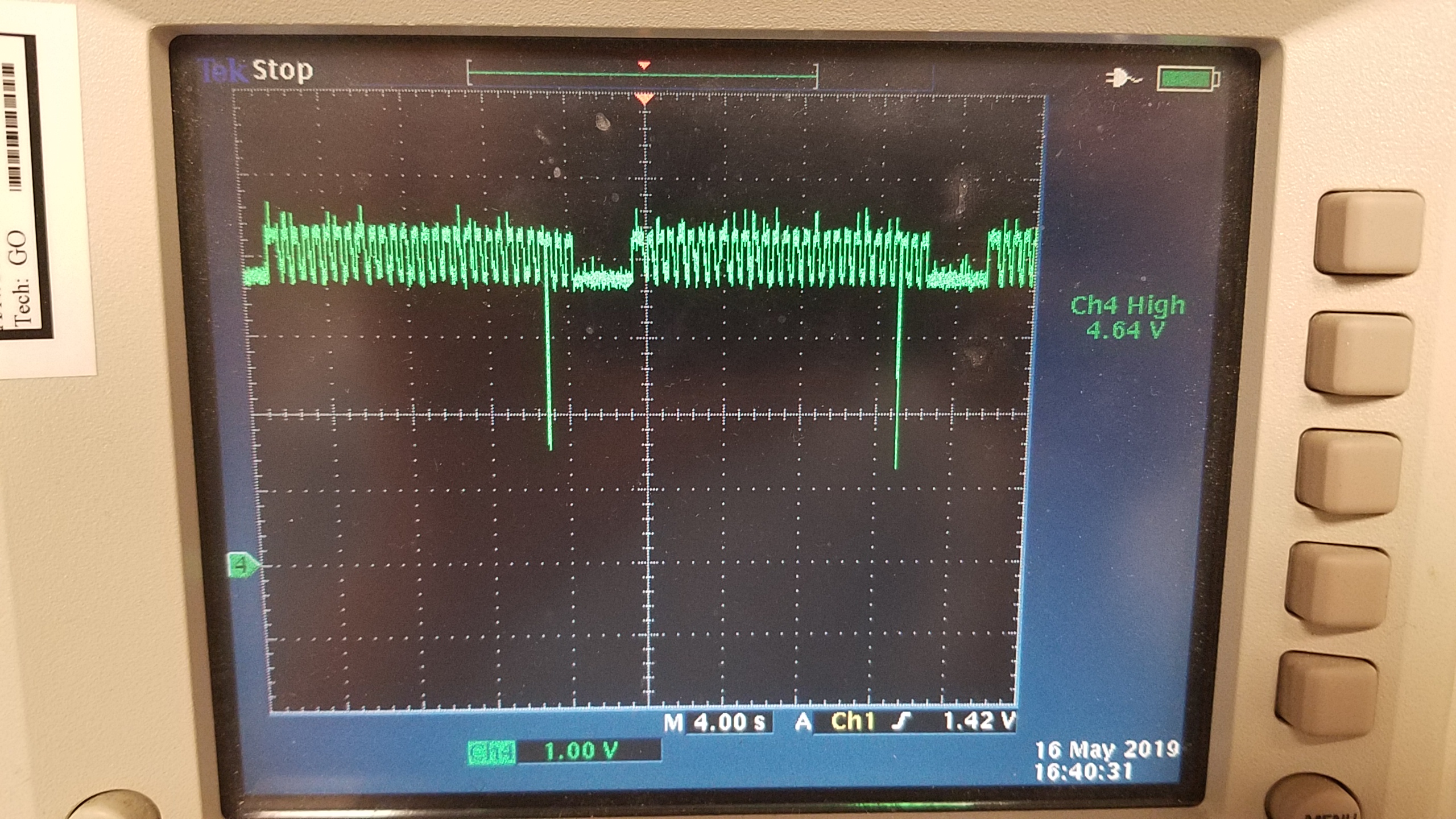

We want the device (VSYS) to be powered-up whenever VBUS is available, regardless of the battery condition. With the battery physically disconnected, we notice that VSYS oscillates between 4.2V and 3.8V, so the device does not power-up. See the attached picture. How can we disable this VSYS oscillation under the SW control, so that the device (VSYS) can be powered on, and remain powered on whenever VBUS is available, even when the battery is completely depleted or removed?
    This VSYS oscillation is happening because with no battery connected, the charger enters and exits charging states continuously. One possible solution is to disable charging when there is no battery connected. With charge disabled, VSYS will be regulated above SYS_MIN and will not oscillate.

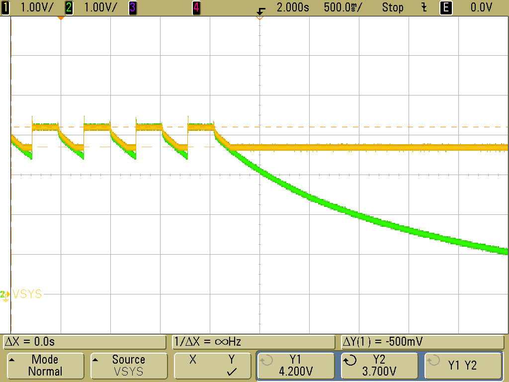

  • Hi Sungwon,
    The behavior you're describing is not the expected behavior. With charge disabled and no battery connected, VBAT should not oscillate. Please see the waveform below. I set VBUS to 5 V and had no system or battery connected to the EVM. Initially, VSYS (yellow) and VBAT (green) both oscillate during float charging, but after charging is disabled, VSYS and VBAT both stop oscillating. VSYS is regulated above the minimum system voltage, while VBAT decays to zero.
    Can you describe your test setup in more detail so we can determine what could be causing the behavior you're seeing?
    Angelo

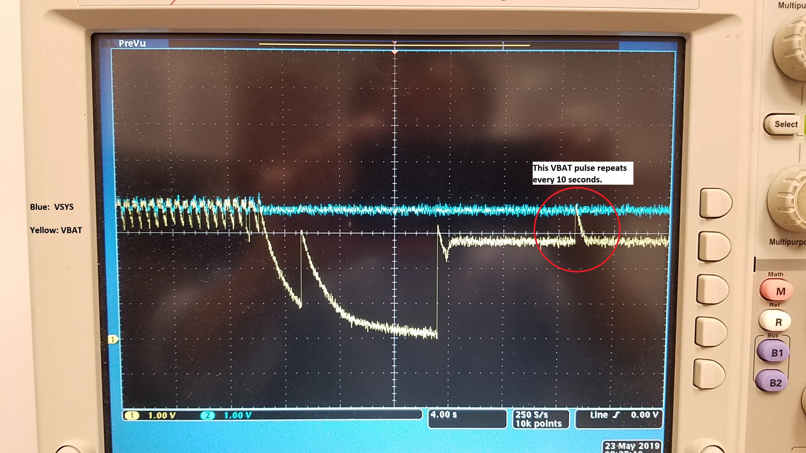

  • Hi Angelo,
    I agree with you when there is no battery connected - both VSYS  and VBAT does not oscillate with Charging disabled in register 1, although there is a repetitive VBAT pulses (see the attached) unless Termination is also Disabled in register 5.  I have not figure out yet how to make the VBAT stays low at 0V. It currently stays around at 2.8V (w/ no battery) after 'float charge' pattern disappears.
    What I want is to be able to bypass the battery under the software control, whether the battery is depleted or removed, so the device (VSYS) can power-up from VBUS input, regardless of VBAT condition. I want no precharging and no CC/CV charging activities to occur - which only makes the device to wait indefinitely during power-up if the battery is dead.
    Sungwon

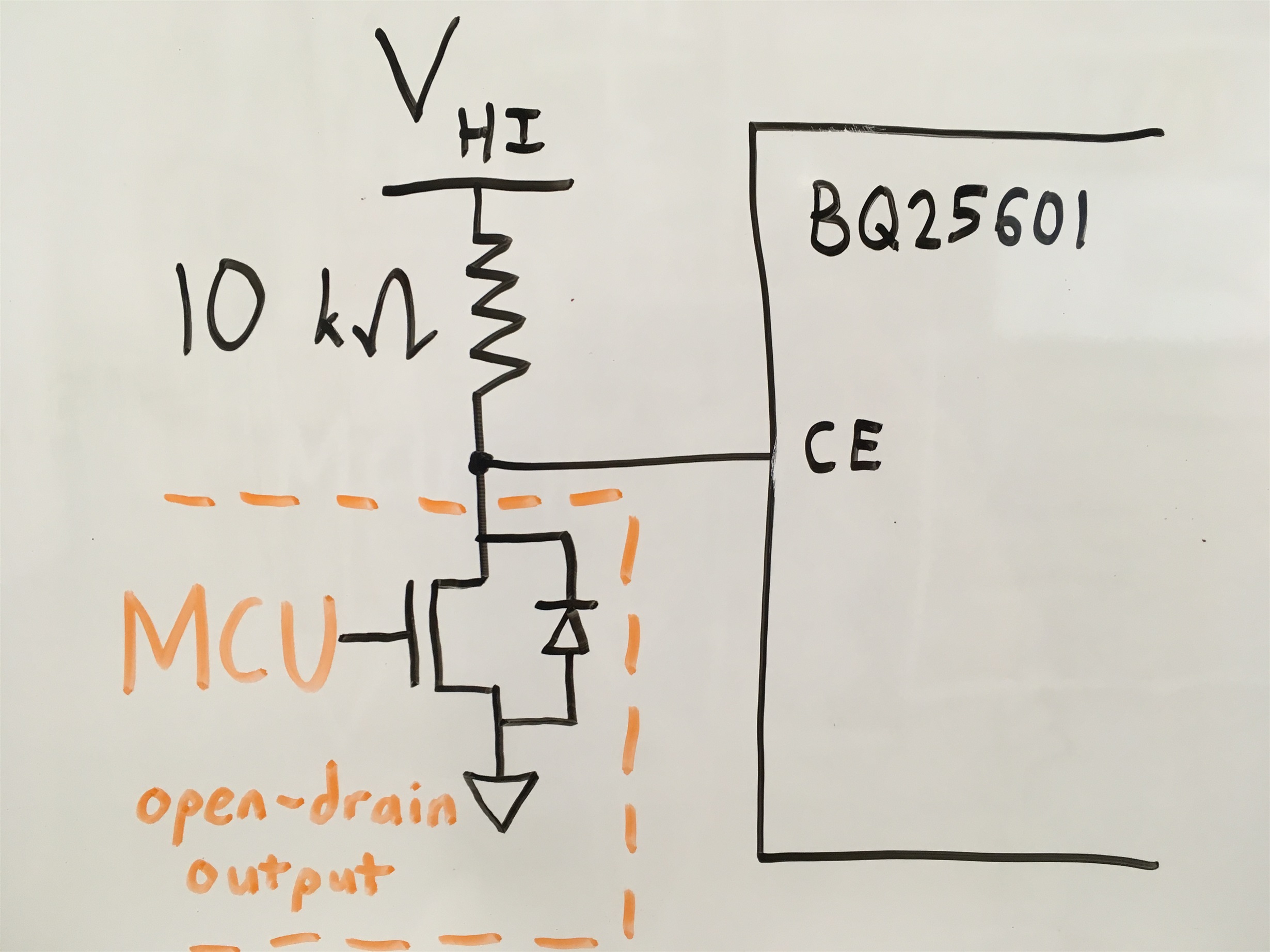

  • Hi Sungwon,
    If you want charging to be disabled at POR without having to wait for the host to disable charging, then you can connect a pull-up resistor to CE and use an open-drain output from your MCU to pull CE low and enable charging, as shown below.
    Please take a look at this thread as well. Some of the suggestions may also be helpful to you, such as the TS pin solution and the BQ24266: https://e2e.ti.com/support/power-management/f/196/t/796672

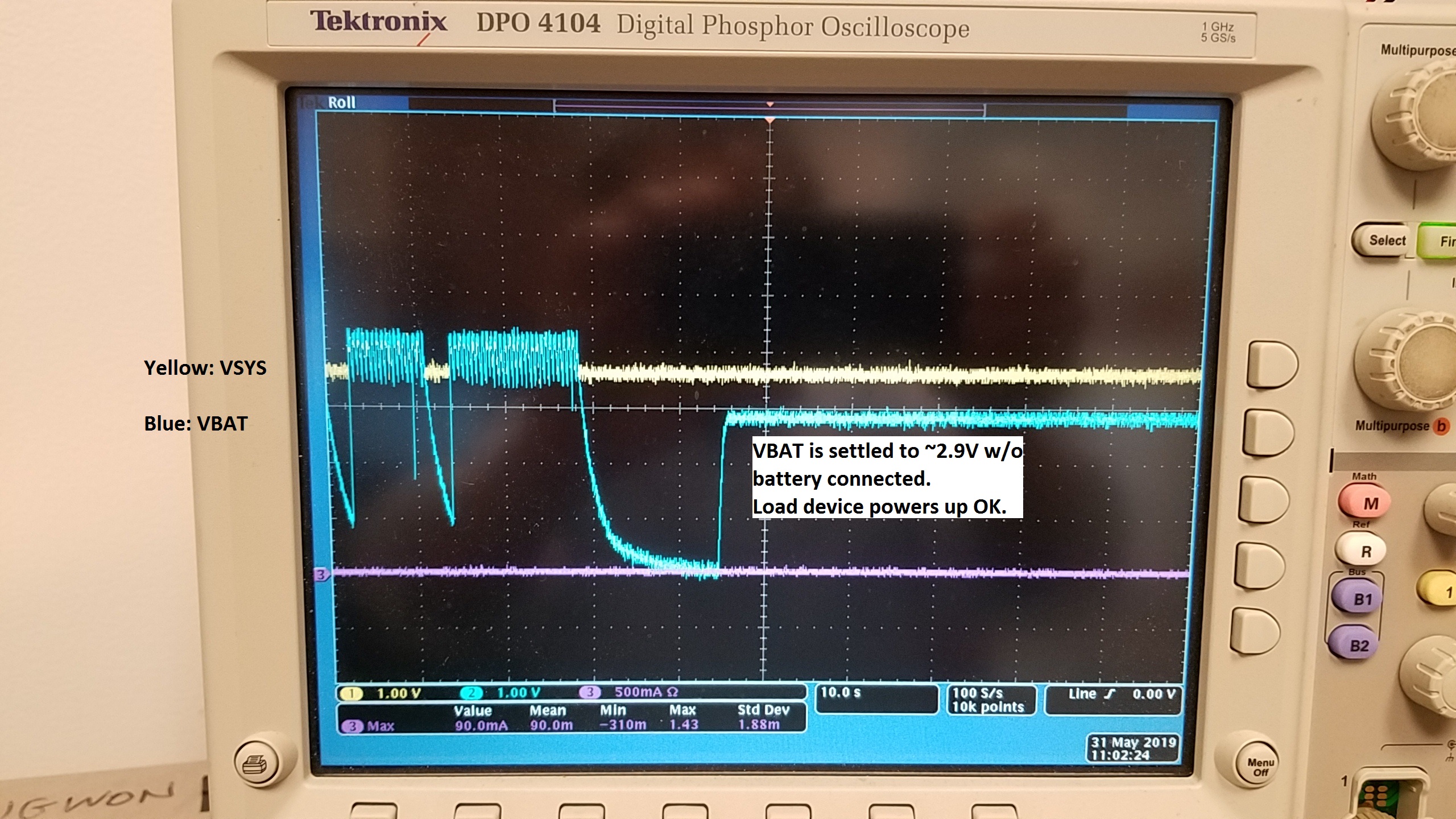

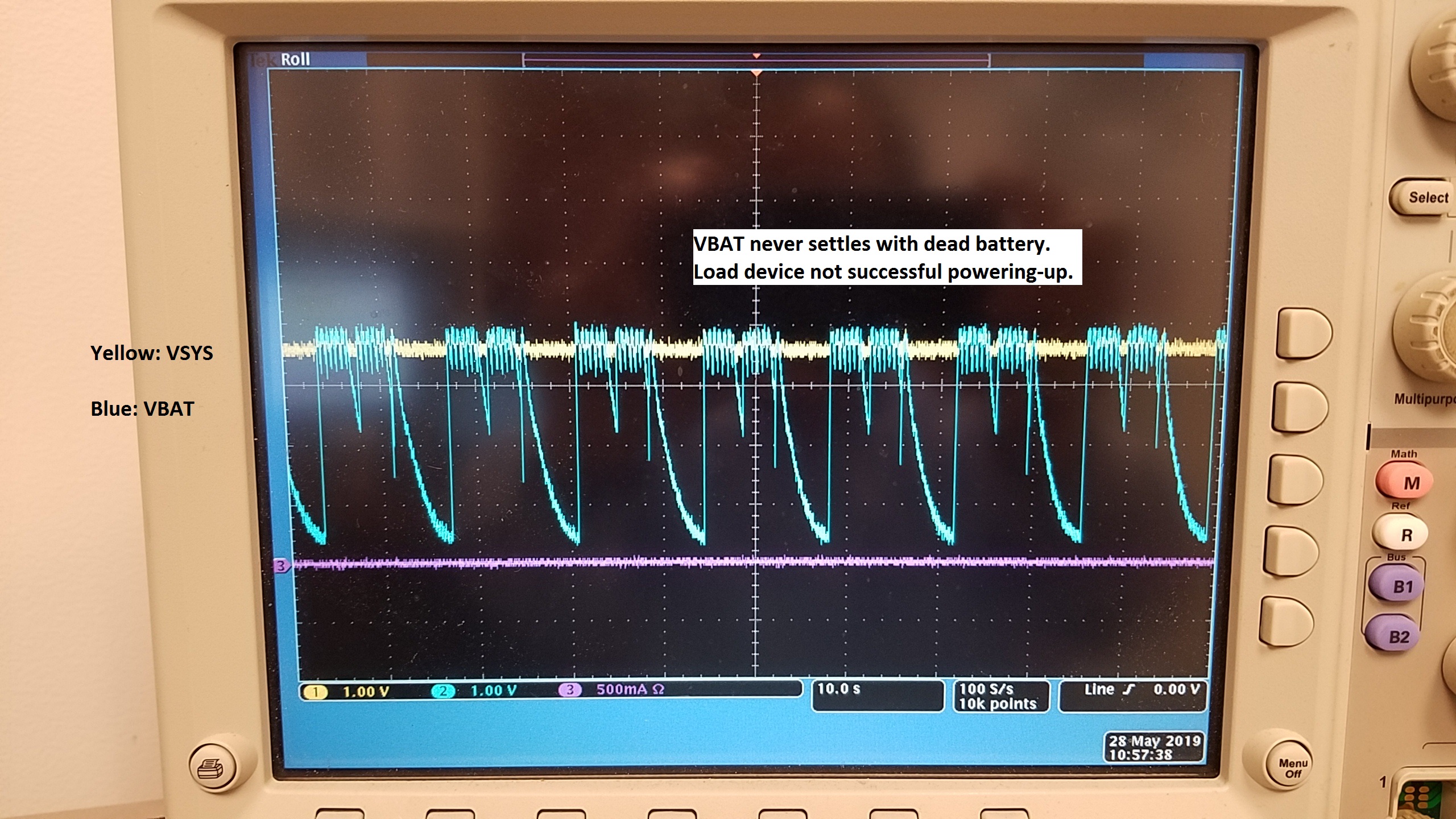

    The problem is the host does not power up with VSYS alone. I suspect that it is because the charging is enabled in the charger chip with dead battery (VSYS is 3.5V)?  It keeps cycling the power-up routine, but does not complete it successfully. See the attached picture 1. But the host powers up normal if no battery is connected (VBAT is settled to ~2.9V).  See the attached graph 2 with no battery case.
    What do I need to do in the charger chip to allow the load device to power-up with VSYS alone? Or, is it probably outside of the charger chip's control that prevents the load device to power-up?
    Picture 1 Unsuccessful power-up w/ dead battery
    Picture 2   Successful Power-up w/ no battery
