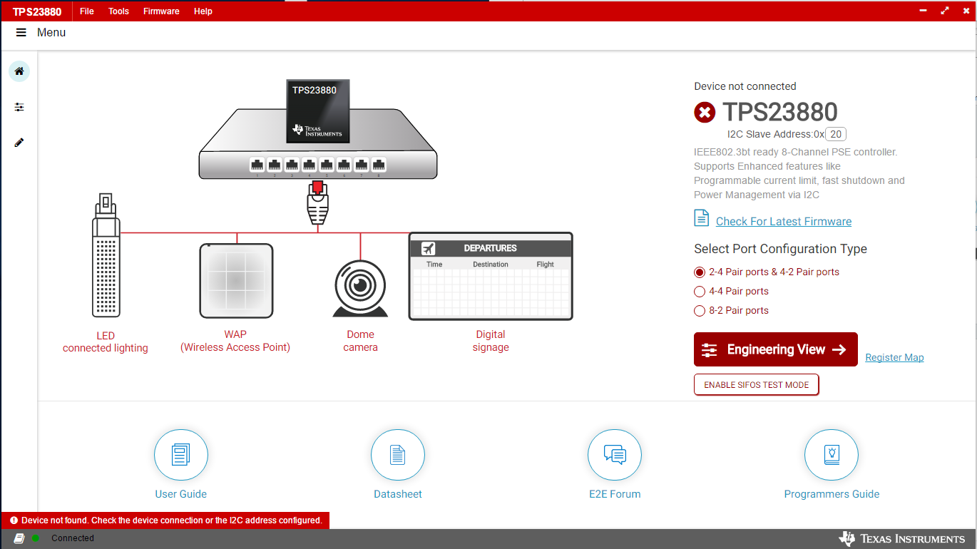

I am trying to interface between my PC and the TPS23880 EVM using a USB2ANY device and the TPS23880 EVM applicationm. I first connected the USB2ANY device to my PC via USB, and ran the USB2ANY Explorer application. I followed the instructions to install the firmware (version 2.8.2.0) by detaching the USB, then simultaneously pressing B1 and reattaching the USB. I was then able to successfully control the USB2ANY device using Explorer. Next, I opened the TPS23880 GUI (while the Explorer was still running), and was presented with the following startup page. Note that both connection indicators are red.

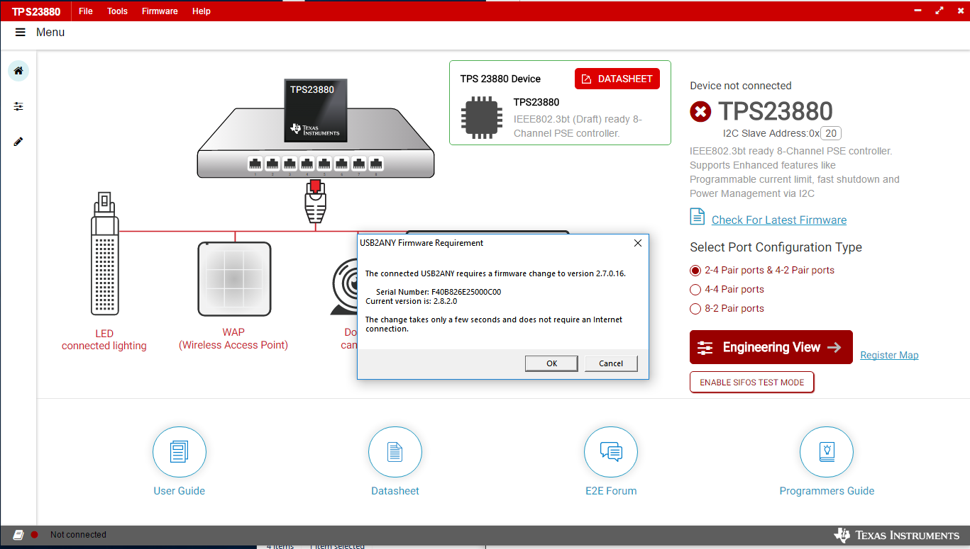

Next, I tried closing the GUI and Explorer and then launching the GUI only. This caused the firmware updater prompt to appear (the same happens if I press "close device" in the Explorer, then launch the GUI):

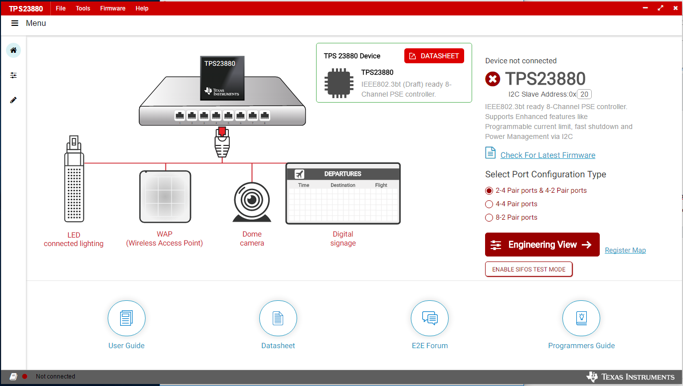

If I press cancel, the startup page looks like this:

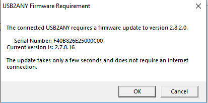

If I accept the firmware version change and rollback the version to 2.7.0.16, I can open the TPS23880 EVM GUI with the familiar startup page:

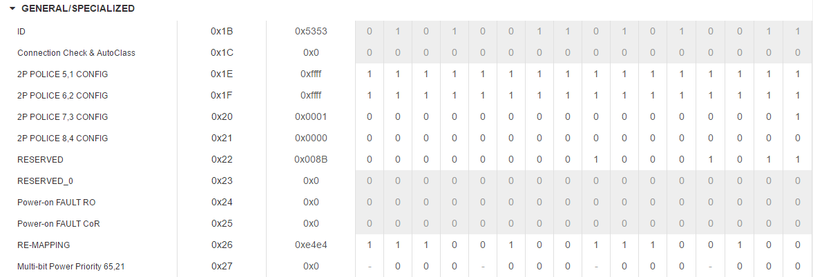

However now I can write to registers in the engineering view. Note that 0x1B has value 0x5353 instead of 0x5555 like it should. If I open Explorer with the GUI still running, I get this message again:
However if I launch Explorer now I get the following firmware version prompt:
At this point if I open the GUI, I can no longer connect to registers and both indicators are red. This persists even if I press cancel, until I close and then reopen the GUI, and in this state it is not possible to open the USB2ANY device using Explorer. If I press OK, the firmware is updated to 2.8.2.0 again and the cycle repeats.

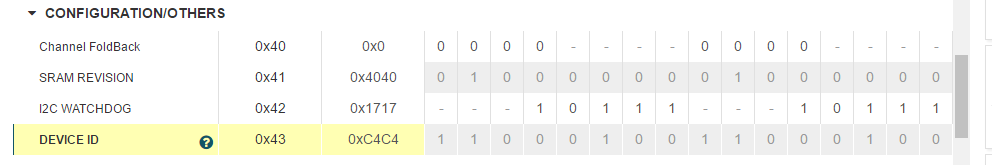

    What would you recommend that I investigate? It seems that I can read and write to registers, but can't automatically upload firmware code to the SRAM. Here are some screenshots of the GUI that might be helpful:

    If the GUI reads the register 0x43 from the PSE device correctly, the device you are talking to is TPS2388, not TPS23880. Can you double check the IC on the EVM is TPS23880 or TPS2388? Is the EVM orderable number TPS23880EVM-008 or TPS2388EVM-612? A picture of your EVM can also help me to verify the hardware. Thanks.

    Thank you! It is the TPS 2388 board -- I should have checked that the datasheet matched the actual device. I installed the correct GUI and that resolved my problem.
