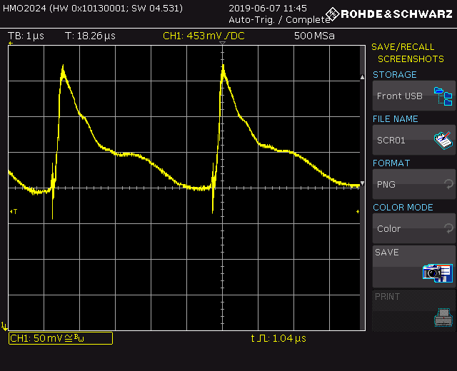

  • Hi Youhao,
    Okay, well let's see what the inductance really is. I just finished the test you mentioned, see the following screenshot.
    Just to note, with this test I have no capacitors on the current sense signals (also not the 100p capacitors), and I have no components on the IMON signal (except the other LM5170 IC).
    I hope the data provided is sufficient.
    Allard

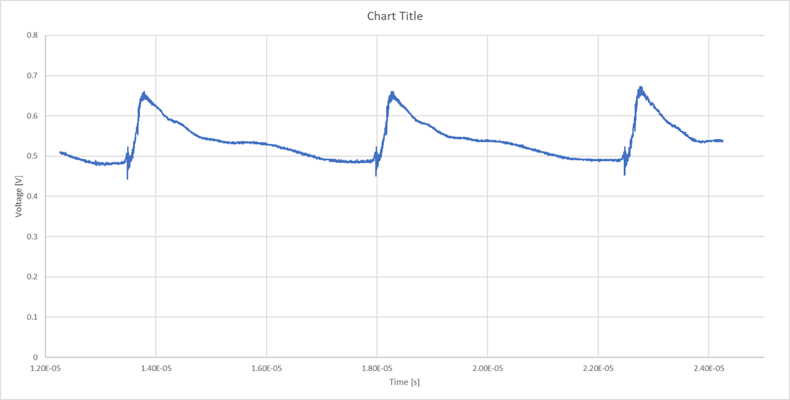

  • I also have the data exported to excel:
    TRC01.xlsx
  • Hi Allard,
    Thank you for the scope picture.  It may not be captured properly.  I just asked you to remove the capacitor at the IMON node, but you need to keep the resistor.  IOUT pin is a current source, you must convert it to a voltage by terminating the signal through a resistor across IOUT to AGND.  We recommend to use 9.09k for single phase. Your IMON seems combining all IOUT pins of different LM5170s.  Please just enable one LM5170, and one channel, and measure the IOUT voltage without placing a capacitor but just a single 9.09k resistor.
    Youhao
  • Hi Youhau,
    I was not clear with my message, I did keep a single resistor on IOUT and I had just one channel enabled. I kept the original resistor tho, 2k26 instead of 9.09k.

  • Can you tell what is your Vin and Vout when capturing the scope picture?  Also, we need the probe to be dc coupled, not ac coupled, so I can see the actual IOUT voltage across the resistor.
    Youhao
  • Vin is 12V and I don't know what Vout was, I have to redo the test to find Vout.
    The probe is DC coupled, I just changed the offset such that the wave is in the screen. I also provided an excel file with the raw values, if I make a chart with this data I get the following:

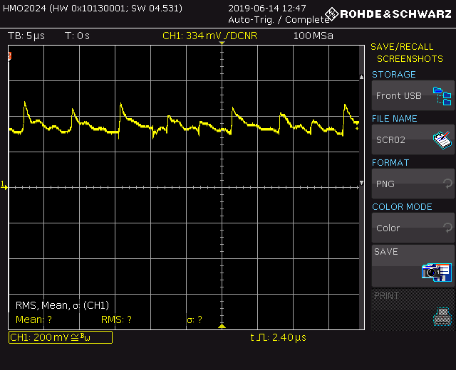

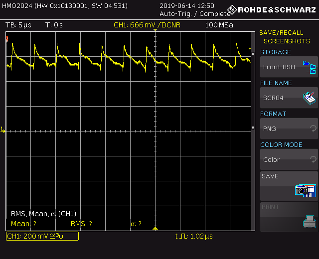

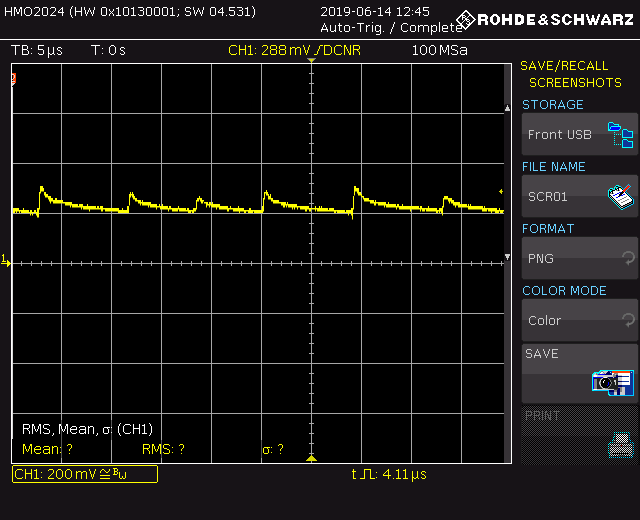

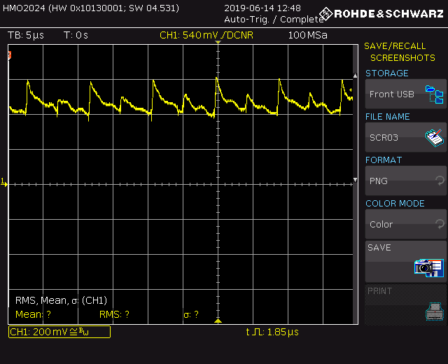

  • Hi Youhao,
    I have redone the test, with 12.1V input voltage, just 1 channel and a single 2.26k resistor on IOUT. I have plots for an ISET voltage of 0.5V, 1V, 1.5V and 2V, see below.
    Plot 1, IOUT voltage; (ISET = 0.5V, VOUT = 110mV):
    Plot 2, IOUT voltage; (ISET = 1V, VOUT = 215mV):
    Plot 3, IOUT voltage; (ISET = 1.5V, VOUT = 315mV):
    Plot 4, IOUT voltage; (ISET = 2V, VOUT = 415mV):
    I hope this is what you need to calculate the parasitic inductance of the sense resistor, if there is anything else you need please let me know.
    Allard
