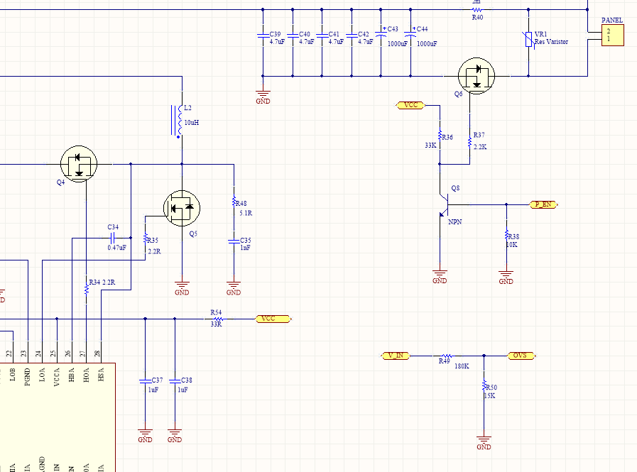

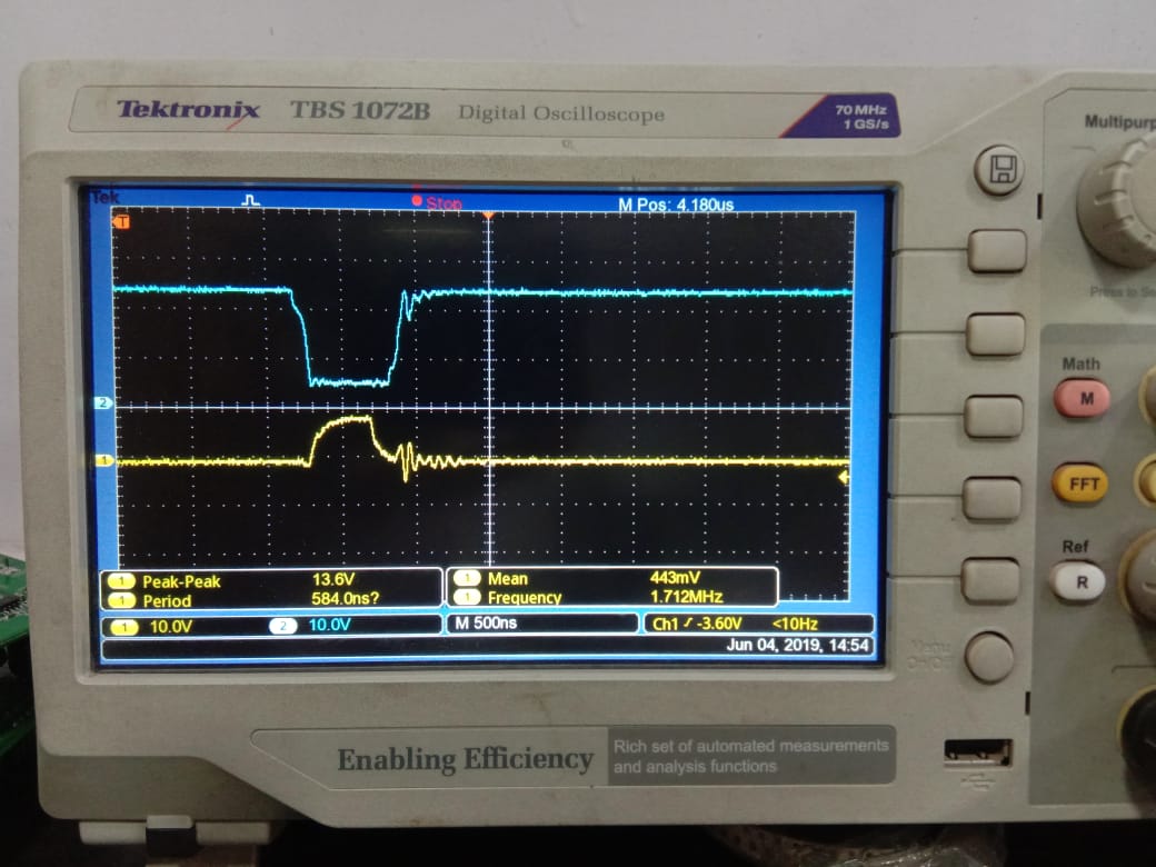

I had design solar charge controller in street light using SM72295 . the design is working good for two to three days . after that Internal driver of SM71195 getting damaged.

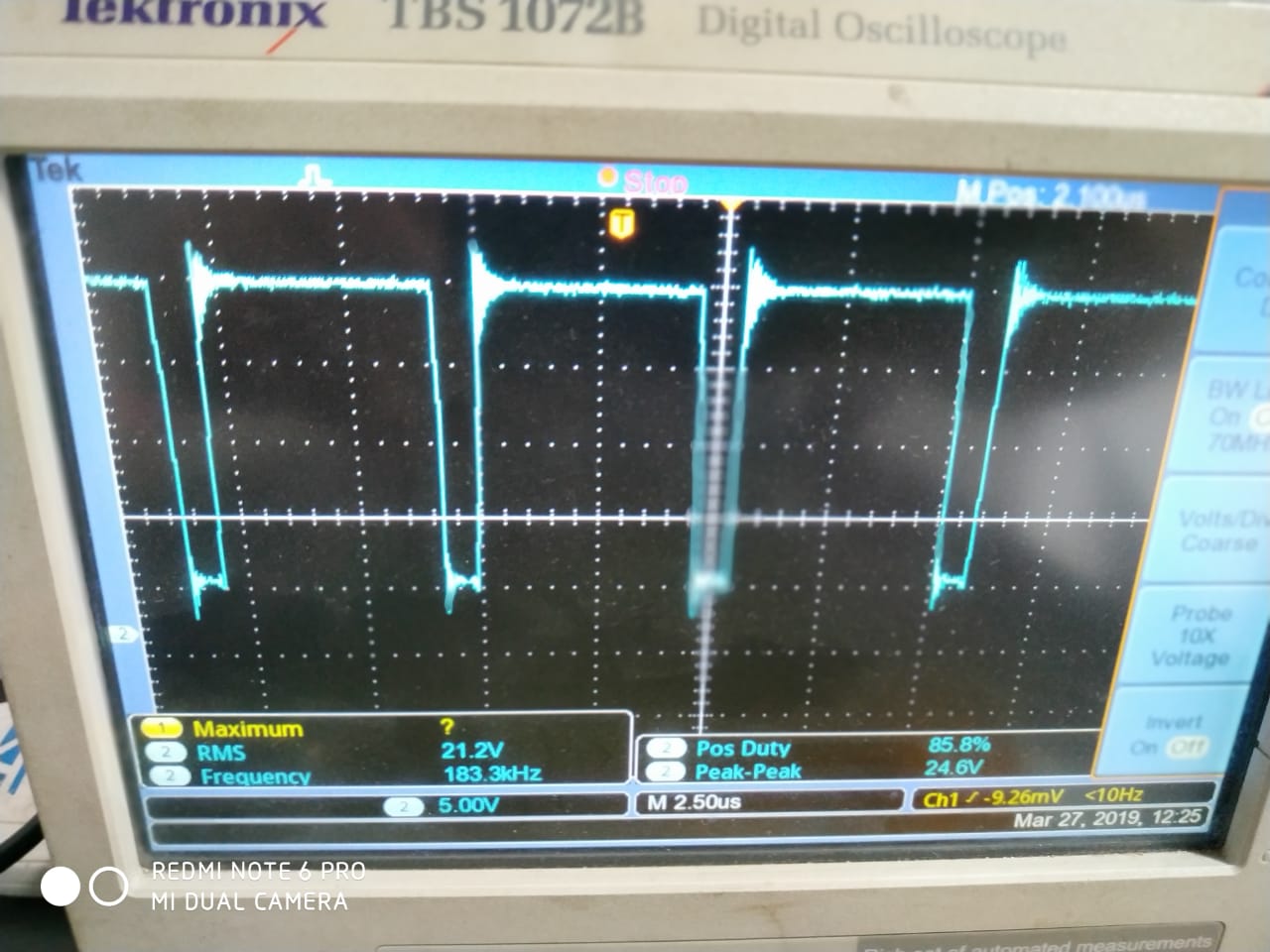

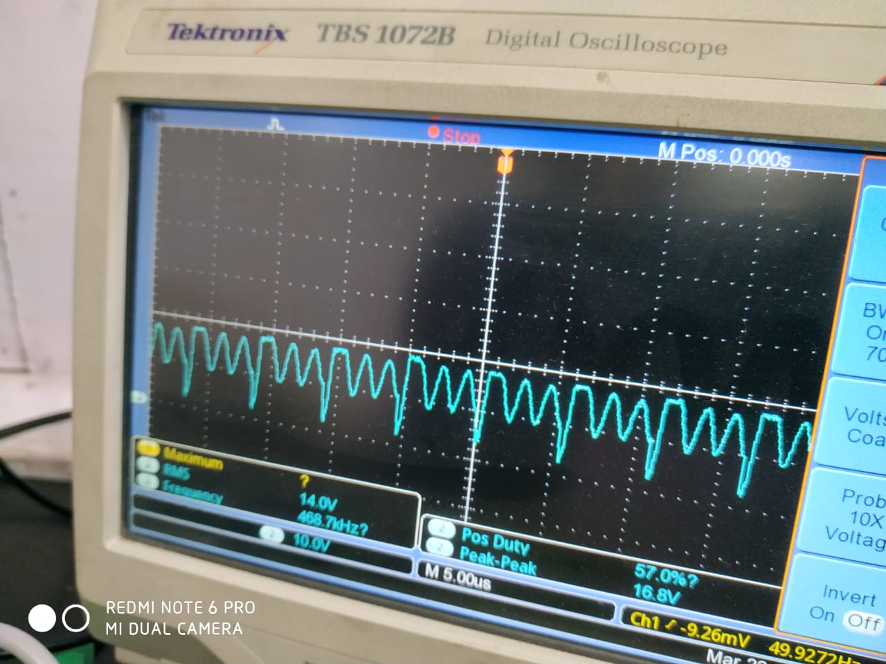

after investigating on CRO i am able to see distorted wave form as mentioned below pics.
before damaged :
while testing thru multi meter i found shorting between HOA (Pin 27) and HSA (Pin 28).

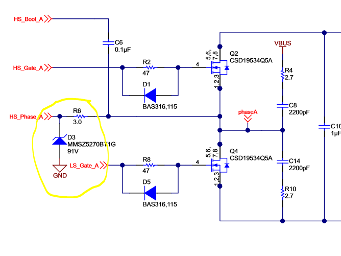

for driver protection can i use zener diode as i found in EVM , if yes then how to calculate the value of zener diode ?
Design Specification :
Panel Voltage mini/ max. : 15/24 V
Battery with BMS : lipo4 12.8 V/30Ah BMS rating (5A)
Charging Current : 5 A Max.
I am Driving SM72295 driver at 8.7V

    It looks like the HB high-side supply is not getting charged by the VCCA cap during high-side turn on. But you also mentioned that the driver was working for a few days without issue. If the HOA output was shorted the HOA-HSA waveform should stay flat at 0V. Since there is not any max voltages being exceeded on the output you may not need zener clamp and only need to tune your gate drive capacitance. The bootstrap cap looks to be correct as recommended in the previous e2e post. I see the VCCA cap in this sch is 2x1uF. Can you confirm this is correct? The VCCA cap should be 1X1uF. Does changing this cap help solve the problem waveform you are seeing? is the same or similar issue happening on HOB? please let me know if this helps solve your issue.
  • Yes i am using 2X1uF cap.1 cap is for VCCA and second is for VCCB . and I am Using Only HOA.
    I am using HOA and LOA for charging and LOB is for LED mosfet driver. HOB i am not using .

    VCCB and VCCA are separate pins so you must be shorting VCCA and VCCB? is the VCC cap and HB-HS cap placed close to SM7225?
    Its possible that HB-HS cap is not being charged properly, can you scope the HB-HS waveform to see that its being recharged every switching cycle?
    Also, can you replace SM72295 with a new one and test everything out with a 50% duty-cycle (probe HOA-GND LOA-GND and HSA-GND waveforms) to see if the low-side is bringing the switch-node to ground in time to create the recharge path needed to charge back up the HB-HS bootstrap cap.

    I notice that C6 in the top sch is 100nF however C34 in the bottom sch is 470nF. Which value cap are you testing with? it should be 470nF. Also the gate resistor value differs between the top and bottom sch, what value gate resistor are you testing with?

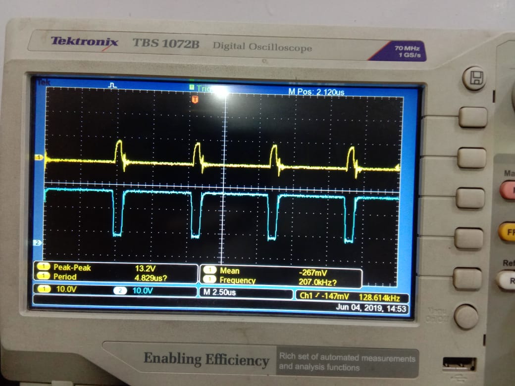

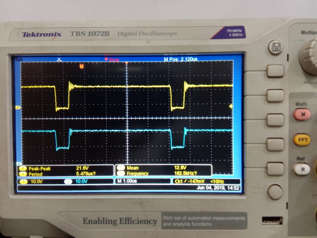

    Please find waveform across HB-HS with respect to ground.
    Please find  HOA-GND  & LOA-GND waveforms below :

    The waveforms you shared look normal to me and the fact that the HO output is normally open after the part is removed may mean the SM72295 is not damaged at all.
    I see that STP150N10F7 which has about triple the gate charge (120nC) compared to the TIDA-00120 which uses CSD18532Q5B and recommends 470nF bootcap for a 40nC gate capactiance. Typically the bootstrap cap needs to be 10X the gate cap and the VCC cap needs to be 10X the boot cap in order for the bootstrap cap to remain replenished during normal operation. Does changing the bootstrap cap value to 1.2uF and adding a 10uF cap to VCC help with this issue?

    Please find the schematic below .2553.TI_MPPT_SSL.pdf

    Is LOB acting the same way as HOA is acting during the issue? if so both C37/C38 may need to be 10uF. You then can add a 1 uF cap at the pin for noise filtering if need be.
