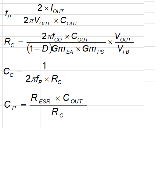

Here are the details of my TPS61088 IC's application.
  • Switching Frequency (Fsw) - 600 kHz
  • Frhpz                                   - 225.71 kHz
  • Loop Gain crossover frequency (Fc) - 45.14 kHz
  • Output derated capacitance - 32.35 uF
As per the formulae in the datasheet, calculated values for R5, C5 and C8 are as follows.
  • R5 - 53.88 kOhms
  • C5 - 1.7 nF
  • C8 - 0.29 pF
And selected values for design are
  • R5 - 53.6 kOhm
  • C5 - 10nF
  • C8 - Left open as the calculated value is less than 10 pF
Please suggest whether we can go ahead with the selected values in the design?
