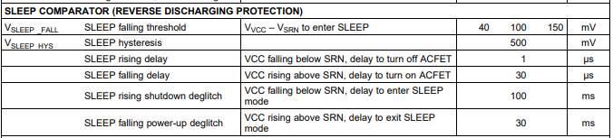

       1) Input power is referring to your power source used to supply VCC. It looks like the power is not enough to supply the input current and input voltage, causing the input voltage to droop (there is no input voltage regulation loop on BQ24610). When the voltage starts to droop it will hit the SLEEP (VCC-SRN spec) threshold causing ACDRV to switch over to BATDRV.
      2) Here is the SLEEP specification:
    Once you hit the SLEEP condition adapter is disconnected by turning off ACDRV. As there is no load on your input power supply the voltage can go back up to the setpoint, and satisfies SLEEP hysteresis  to exit sleep so BATDRV will switch back to ACDRV which is the cyclic effect as this will be repeating.
    It is possible that you also just don't have enough headroom between VCC and battery voltage, as this is a buck charger and requires input voltage higher than battery voltage to charge. You can refer to section 11 Power Supply Recommendations for information on valid VCC ranges for your battery voltage.
