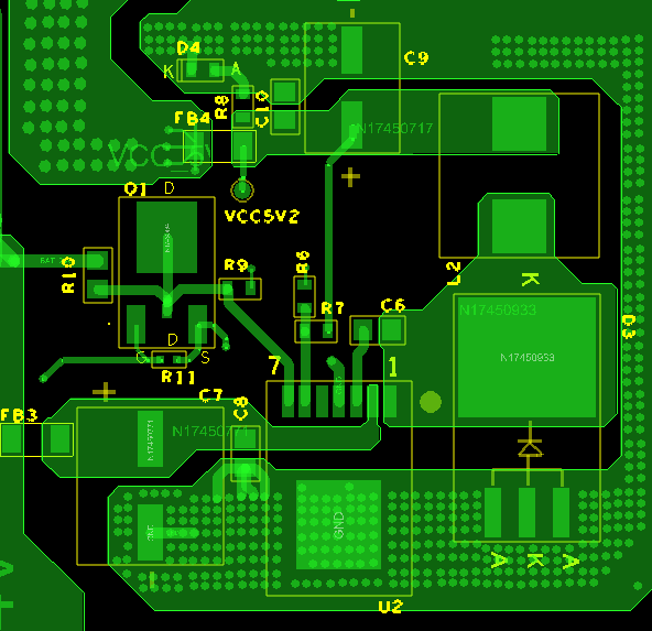

Hello All
We have design Switcher using LM22678J-5 V For 5 A
we need help for Switcher output side noise remove
Please Consider below Component detail which is used
1) Switcher IC Part Number :- LM22678TJE-5.0/NOPB
2) 1st Input Capacitor Part Number :- A767KN336M1JLAE042

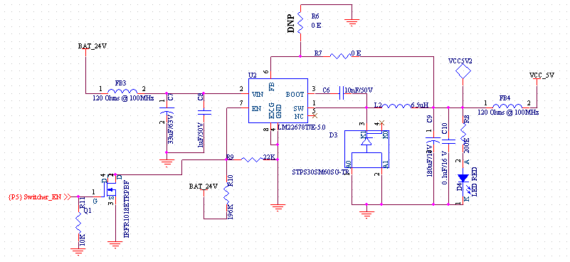

Please find below a screenshot of Schematic
Also, I have attached Layout Image
Image 1 TOP Side
Image 2  Power Side
Image 3 GND Layer
Image 4 Bottom Side

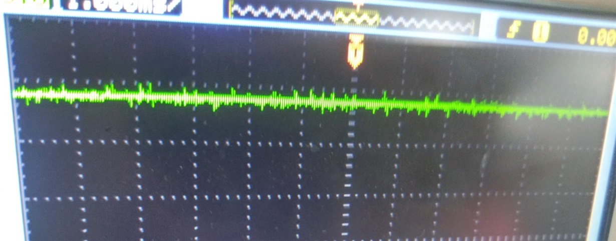

we have issue Face in Output Side Noise present
kindly find I have attached the image of DSO
signal measure at Input Capacitor
signal measure at Output Capacitor
Please suggest how to remove noise at the output side
Thank you in advance
  • It looks like you schematic and layout designations don't match.
    However, there are several improvements that can be made to you layout.
    The input caps must be as close as possible to the device.
    Also, the grounds for the diode, input cap, output cap and the device must all
    be as close as possible.
    You should also try to connect the ground pin of the device to the case and
    ground plane on the top layer.
    In general an LC filter on the output of the regulator is a good way to help reduce switching noise on the output.
  • Hello Frank De Stasi
    Thank you so much for your reply
    I have updated Schematic photos because we will use two types of switcher in our PCB that's way please review it if any other input or suggestion
    Thank you for advance
  • I believe that the points mentioned above are the best starting point.
    Thank you very much for your reply
    we have to remove Ground FB and we have common ground all Switcher measure voltage on CRO so Flatulation is 0.170 to 0.200 mV
