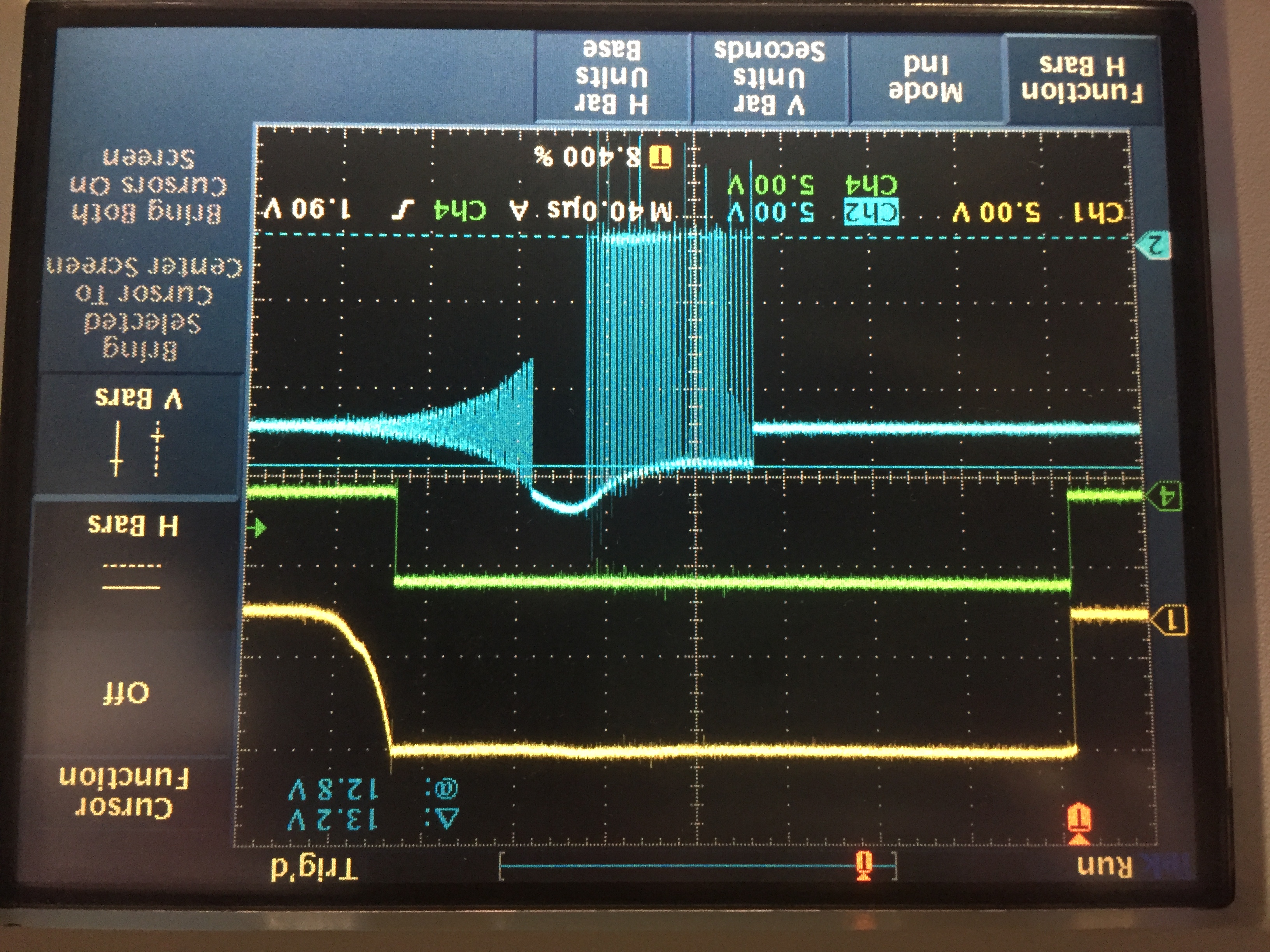

Hi, I'm working on an LED driver board, and I'm running in to some unexpected behaviors.    (Please see attached scope screen shot).
Topology:  Boost.
Vin:  11 volts
LEDs:  a chain of 5 with a forward voltage of 2.8-3.5 volts depending on current
Using low-side LED current sensing, Rsense = 0.10 ohms,  Viadj = .14 volts
Using PWM dimming, with a low-side FET
So, the questions are:
Why is the switching not even starting till half-way through the On-period?
Why is the LED voltage rising?
Why is there some ringing a little bit after the switching shuts off.
And any thoughts or theories as to what could be causing this?
For the screen shot:
   Channel 1 (yellow):  the PWM FET Gate voltage
   Channel 2 (blue):  the voltage at the Source of the switching FET.
   Channel 4:  The PWM input signal.
Thanks in advance!
-Michael Shonle

  • Sorry, Hopefully it worked this time, thought I had already done it...
  • Hi Michael,
    First with VIAJ at 0.14V...This is on the really low side of what the part can accept (see section 7.3.7) because of the offset in the current sensing circuit.  How low of a current are you trying to control?  Please give us your specification as far as output voltage range of the LED and the current range.  In addition, please forward me your schematic.  I'll comment more when I get these from you.
    The ringing at the Source of the switch FET that is ringing at the end is to to the current in the inductor discharging when the FET is off and going to zero current.  This is normal for any FET and inductor switching circuit.  The ringing is the natural frequency of the inductor and any parasitic capacitance it has on it.

  • Hi, and thanks so much for your help!
    In terms of the overall design, we are actually wanting to run a chain of 15 LEDs at 5 amps pulsed (so about 60 volts total), with a 1 % duty cycle, but wanted to start slow and work our way up.  We did try increasing the Viadj to 0.8 volts, but that was even more erratic, with the voltage to the LED going even higher and then shutting it off at apparently the OVP reaching its threshold of 70 volts.

  • Hi Michael,
    The instantaneous power level is really high at 300W.  Did you go thru our design calculation to get your values?  From the schematic the values seems wrong.  The inductor value listed is 26uH but the part number is a 68uH.  In actual design it should be closer 6.8uH-12uH based on your switching frequency of 420KHz (Rt=18.2k).  The schematic shows 24V input...What is the minimum input voltage?  You will need that for the calculation.
    You should not use R14 and D01 unless there is some reason for this.  The turn off time will be slow with this...You should start out with like a 0-10 Ohm on R14 to begin with.
    The compensation seems quite high BW.  You should start with R46 as zero Ohm and C61 around 0.1uF-0.22uF just to get the system stabilized first and you can compensate better later with transient response or sweep the loop.  What you are calling 'erratic' is most likely instability of the loop and this will help with that.
    I would start with low current like you are doing (VIADJ = 0.8V) then adjust up as needed.
    Thanks Tuan
