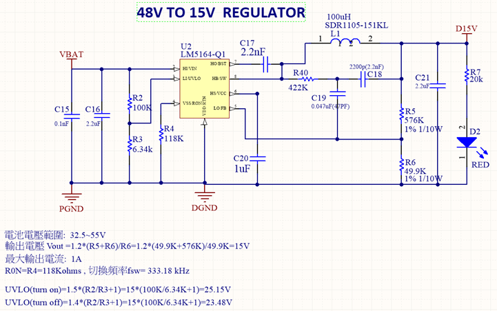

Can you help review our LM5164 waveform and schematics ? We can not get a stable output. Any suggestion?

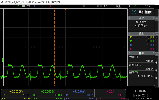

LM5164-Q1 pin 7 waveform

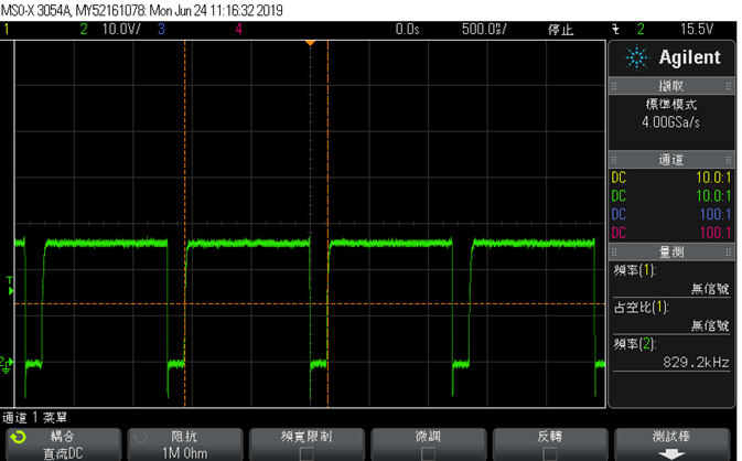

Output waveform as below

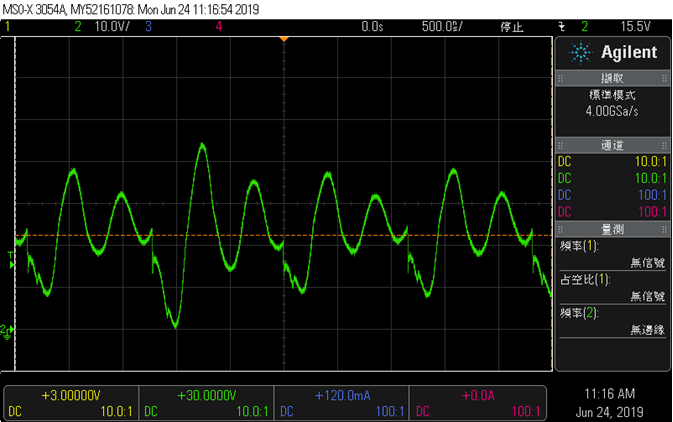

Pin 5 feedback waveform
Below is our schematics
