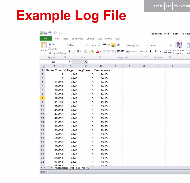

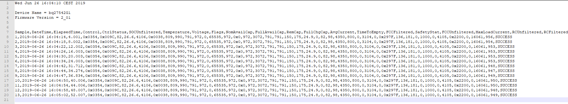

I starts to generate log files, but the result is not the same of what indicated in the video in this link http://www.ti.com/tool/GPCCHEM :
In the video, the output file is csv file is described as below:
My Log output file is .log file and described as below:
5. Is It correct ? or should I generate the same csv template file ? and how?

    1. Even if cell is listed, we still encourage you to run the rel-dis-rel to described in the gpcchem tool ot determine a close chem id for your cell.
    2. see 1 above.
    3. The first step though similar to a learning cycle is not a learning cycle. You are just identifying  a close chem id  match.
    4. if you have a gdk tool, then you should use the gdk mode. Essentially the gdk will automatically control the charge and discharge cycles. You can create use your file as is (just make sure to input the column name correctly in the config file.) or you can just copy out the elapsed time, current, voltage and temperature to create your own log file that will be submitted..
    5. See 4 above.
