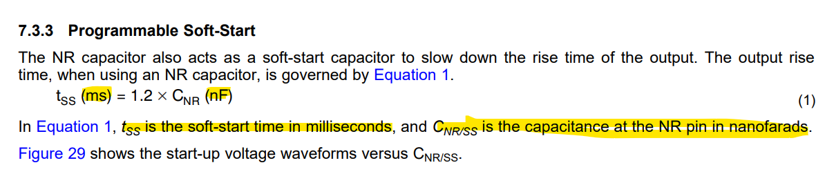

  • Hi Ryan,
    With the recommended 1uF capacitor for the programmable soft-start, the datasheet shows about 40mS turn on time, and that's not what I'm seeing at all for the negative regulator (the positive regulator though tracks very well with what the datasheet startup graph shows).  I'm seeing about 1 second (scope plot attached).  The output load of the -ve regulator (192mA) is similarly loaded to the +ve regulator (240mA) on startup.  The output capacitance is also the same on both rails.
    What would cause the -ve regulator to have such a slow startup then?
    Thanks for the help!
    Ron

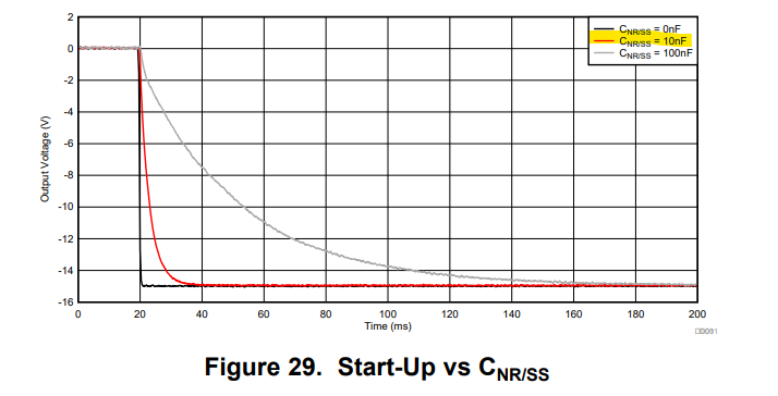

  • Hi Ron,
    Please note that the softstart equation for TPS7A47 and TPS7A33 are different as the two regulators have different topologies.  For TPS7A33, with a 1 uF softstart capacitor you should see a startup time of 1.2 s.
    For a startup time of ~ 40 ms you will want to use a Cnr/ss on the order of 10 nF.
    Very Respectfully,
    Ryan

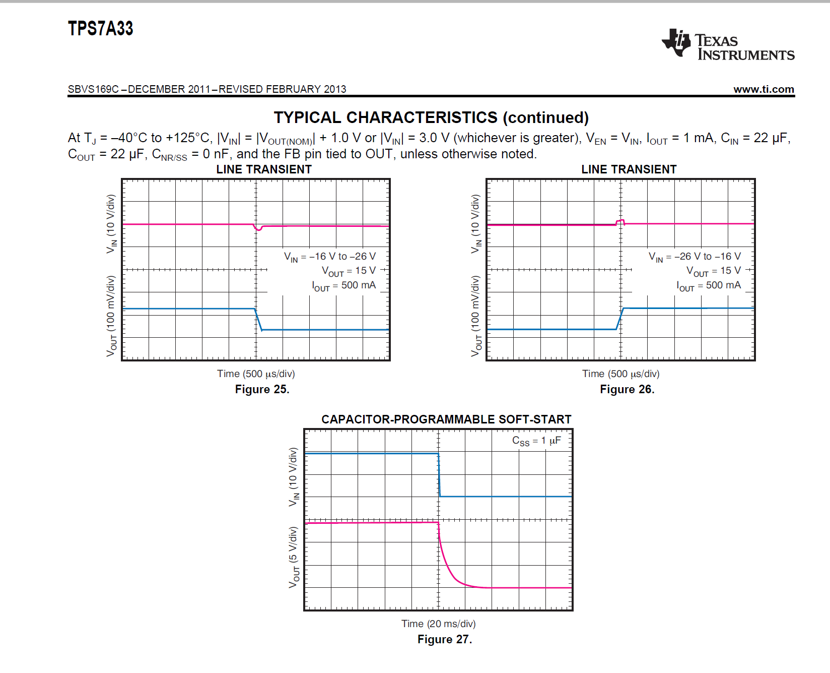

  • I looked at the datasheet and figure 27 shows a 30ms startup time with a 1 uF capacitor (which is way different from what you have in your chart).  I'll try the smaller capacitor and see how it goes.
    Ron
  • Hi Ron,
    It is important to make sure that you are using the latest datasheet revision as found on ti.com.  Please note that a typo was found in Figure 27 and corrected to show that Css = 10 nF in the current revision released April 2015.
    Very Respectfully,
    Ryan
