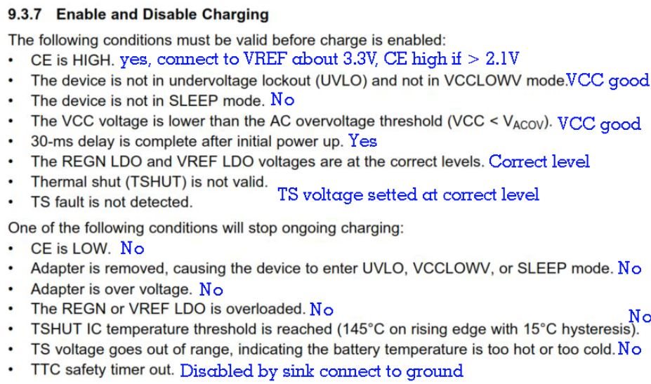

I am on testing BQ24610 chip with Typical Application circuit.,
There is just small modification, I just remove the BATDRV FET and SYSTEM Line, because I just want use this IC just for charging battery.
I am configure the circuit using "bqstroller calculation tools_V1.5"
I short TTC to Ground to disable it.
I want to verify these :
1. Typical Application circuit is for AC input or DC input ? I bit confuse because of the name ACDRV , ACP, ACN , etc. currently I test with 19VDC input supply
2. I wont use Thermistor, so with Voltage divider I set TS pin about 1.6V, is it okay ?
3. I wont use BATDRV, so I am not put BATFET circuit, is it okay ?
4. is it must put Diode zener 7.5V from ACDRV pin to VCC pin ?
5. is it must put Diode from ground to PH pin ?
I think I already meet all requirements to enter charging cycle, but 2 STATs LED always turn OFF.

      By Typical Application schematic, are you testing on the BQ24610 evaluation module or your own board? If it is your own board, can you share with me the schematics?
    For your questions:
    1. 19VDC input is fine
    2. Setting TS to 50% is fine as it is within the VLTF and VHTF thresholds
    3. Yes, when disconnecting BATFET float BATDRV pin and disconnect other components from that pin
    4. No, Zener diode is not required from ACDRV to VCC
    5. No diode from GND to PH is not required.
