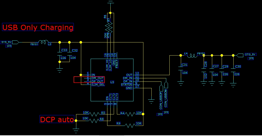

Hello
Please help to check the SCH ,thanks
If only working in DCP_Auto Mode, DP/DM could be floating ?
Hello Fandy,
Yes that is correct. If you are only putting the device in DCP_Auto mode, DM_OUT and DP_OUT can be left floating.
