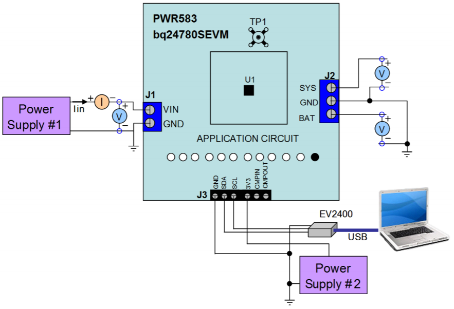

    we are using one SM bus communication for both the battery and the Charger IC(BQ24780S). While connecting it to the EV2300 and trying to communicate between them, Only the Gas Gauge IC (BQ40Z50R1) window get opened and we are able to read the registers, When trying to open the charger IC window it is displaying a DEVICE ACK ERROR and we could not able to read the Register of charger IC.

  • Hi Anandan,
    Are you using an EVM or your own circuit? Please make sure your setup matches Figure 2 below from the User's Guide. In particular, make sure you have the 3.3 V power supply connected. This is important because the 3.3 V power supply serves as the pull-up rail for SDA and SCL.
    If that doesn't resolve your issue, then please let me know what version of Windows and BQStudio you're using.
    Angelo
  • Hi Angelo,
    Thanks for the Response.
    We are using BQ24780S-EVM for our smart battery testing.we are using the same SM Bus communication for both smart charger and Battery communication.
    Our Test setup connections resemble the same as the Image Represented on your previous thread.
    We are using Battery Management Studio(1.3.86) and we are using Windows 8.
    FYI:-The SM bus of both Battery and Smart Charger is connected on the EVM and from this while using we are able to read the battery Register, But not the Charger IC EVM.
    Expecting Your reply at the earliest.
    ANANDAN N
  • Hi Anandan,
    The EV2300 is not supported for 64-bit Windows (Windows 7 and newer). You can try installing the unofficial EV2300 drivers for 64-bit Windows here to see if that resolves your issue: e2e.ti.com/.../458983
    Angelo
