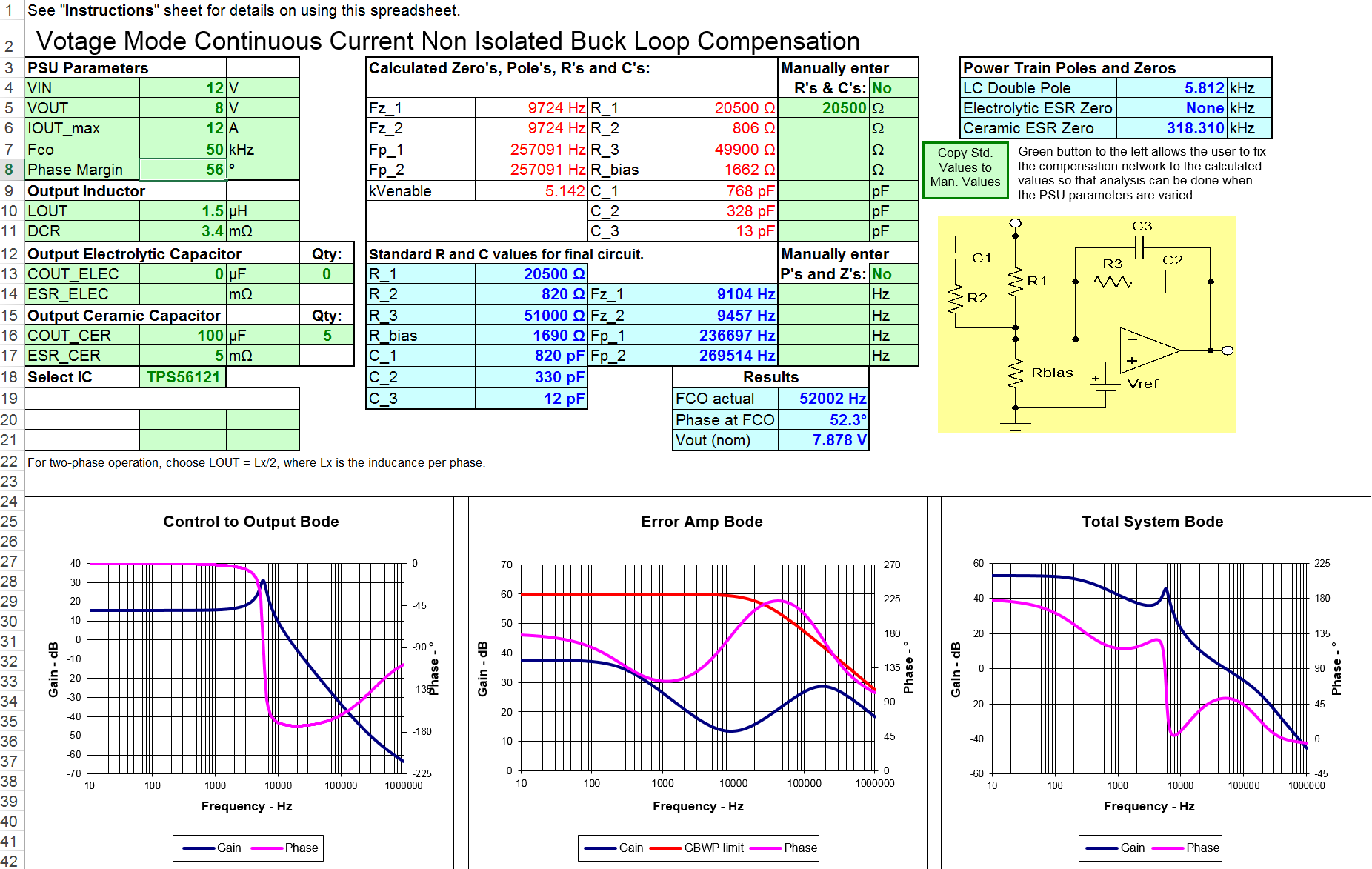

Hello everyone,
I have a question about the compensation tool (www.ti.com/.../sluc263) for feed feedback loop design. I have redesigned my circuit based on 50kHz Fco and 56-degree Phase Margin. My total System Bode plot and Error Amp Bode plot are shown below. I just want to check to make sure that these plots and values are fine.

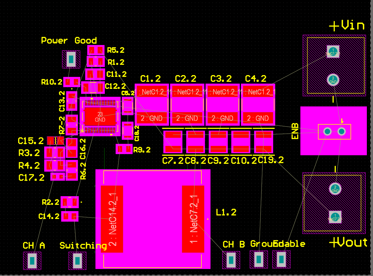

I have also redesigned the PCB layout very similar to the given layout in the datasheet. However, I removed all the elements on the back on the put them in the main circuit.
