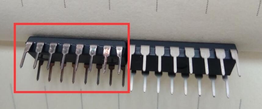

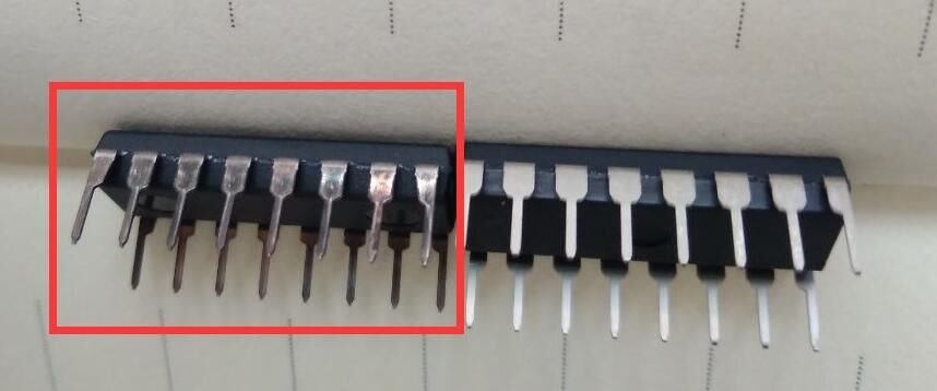

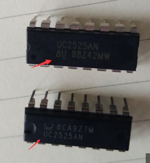

Hello, We bought 200pcs of the part UC2525A from MOUSER, but found there are 2 kinds of making on the part. Like the photo as follows:

The leadframe changed to a roughened leadframe in 2018. Attached report addresses the ‘discoloration’ on the leads and the benefits of having a roughened leadframe.PCN20180329000_Notification.docApplication note Rough LeadFrame.pdf
A PCN, part change notice, went out to customers and shows the qualification the device/package went through. It is likely that there are two different lots of parts in your delivery from Mouser, some from before the leadframe change and some from after the leadframe change.
Peter
