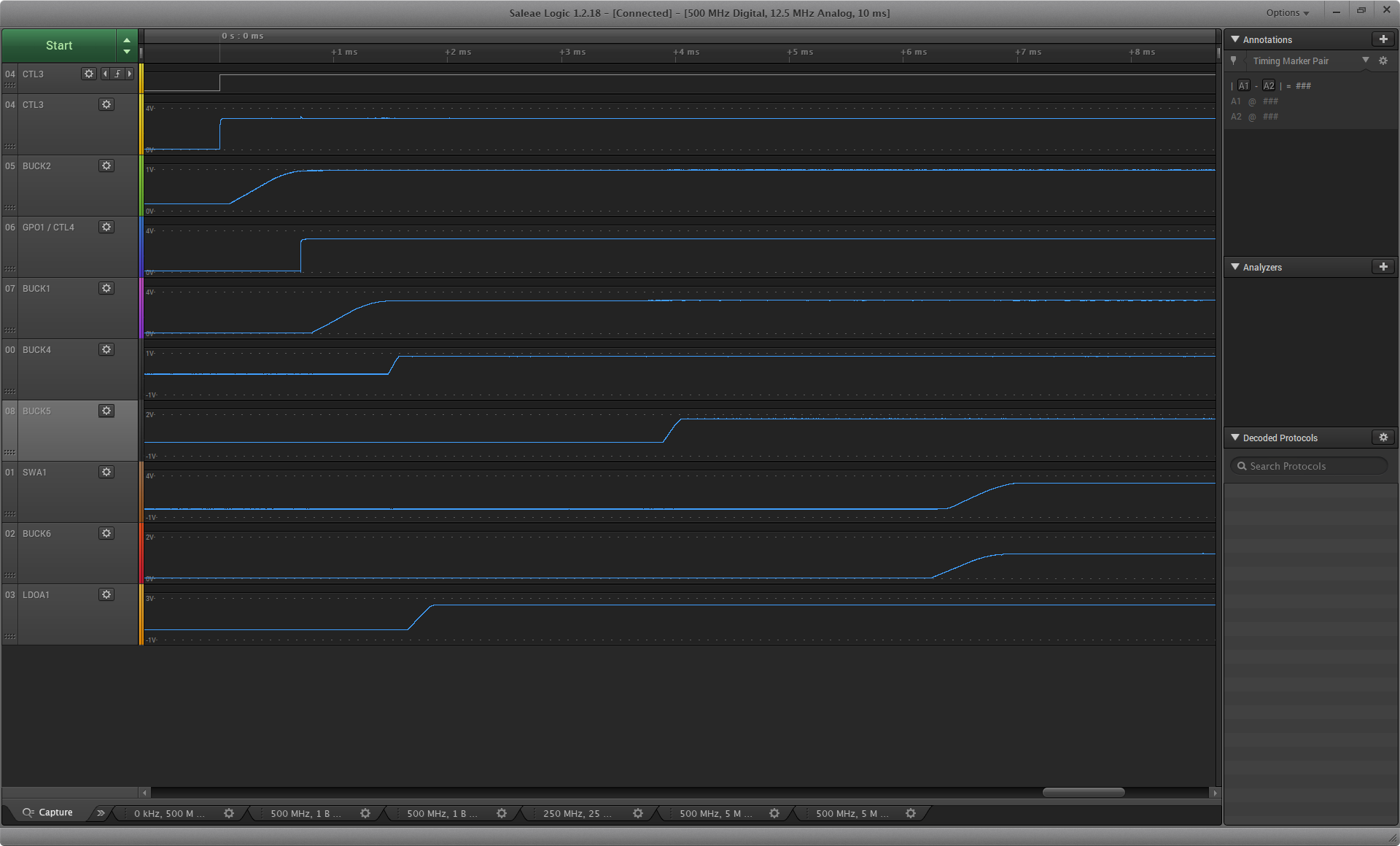

    I will walk through the items listed. In order to try to reproduce, I took a new TPS65086100 unit and used a BOOSTXL-TPS650861 and MSP430F5529 EVM:
    1. They observe SWA1 enabled 120 ms after BUCK6, but TPS6508640 datasheet shows them enabled at the same time.
    I am not seeing this behavior on the BOOSTXL-TPS650861. I have the following jumpers installed: J12, J13, all of J14, J15. With this setup I get the following scope shot:
    SWA1 depends on BUCK5_PG, so it may help to check that BUCK5 and PVIN_SWA1 are both present at the same time.
    2. I am not seeing this behavior either, can you confirm that CTL1 and CTL2 is a stable voltage throughout the start-up sequence? It selects between 1.35 V and 1.2 V.
    3. As noted in scope shot, LDOA1 timing appears correct. LDOA1 depends on CTL1 and BUCK6_PG, it may help to check CTL1 voltage is stable? I also verified that if I change it from BUCK6_PG to BUCK4_PG, I see the sequence change:
    4. Either LDOA1 or SWB2 can be included in the sequence, but not both, because they only have 1 enable tree. Please reference section 4.1.3 in the TPS65086100 Non-Volatile Memory Programming Guide for more information.

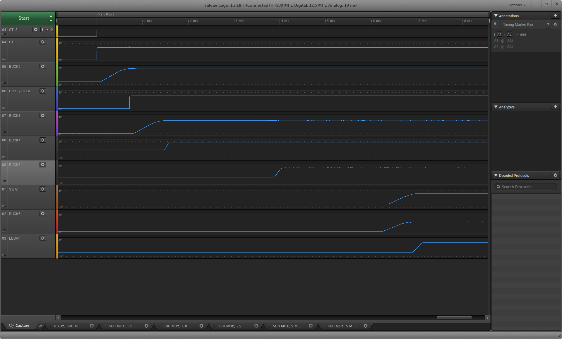

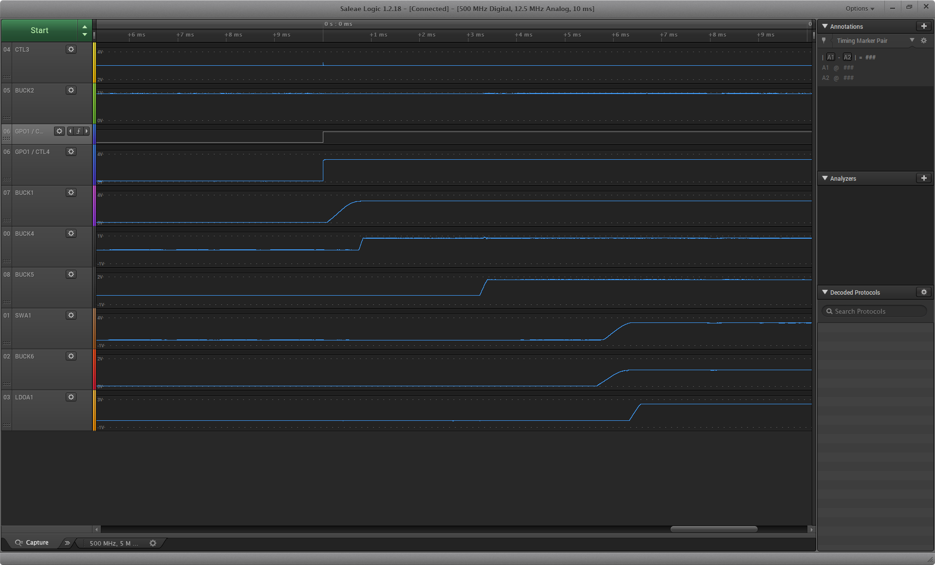

  • Hi Polly,
    I followed your procedure to double confirm and I still see the proper sequence. For example, this is with CTL4 held low intentionally:
    You mention "tab and paste and replace to TPS650861-Script-1p0.js file" - can you provide your current .js file? It is important that there be only one 0x140 in there. That might explain why changing your file did not have an impact.
    I would recommend having both TEST and BURN pins set to OFF position since GUI will control these.
    The last slide looks like a potential undervoltage case, you may want to check that the 5V and 7V supplies are stable, it may indicate that the MSP430 LaunchPad is damaged. Can you clear the UVLO bit and confirm that it stays cleared?
