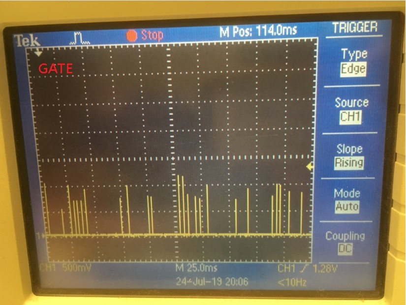

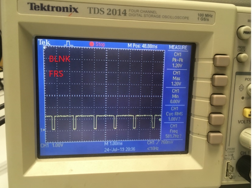

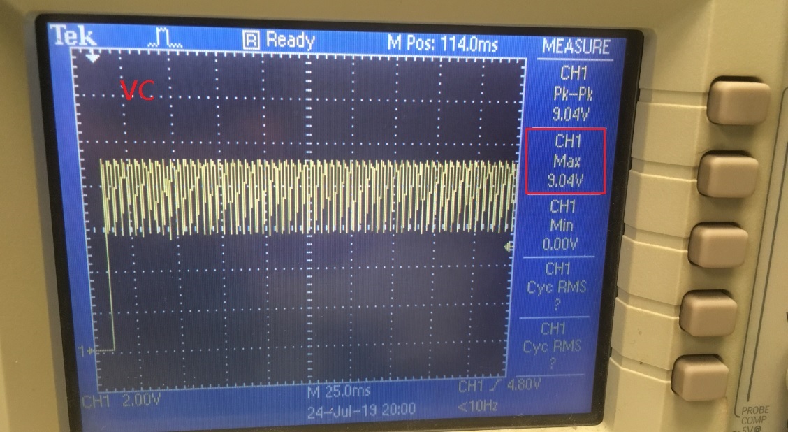

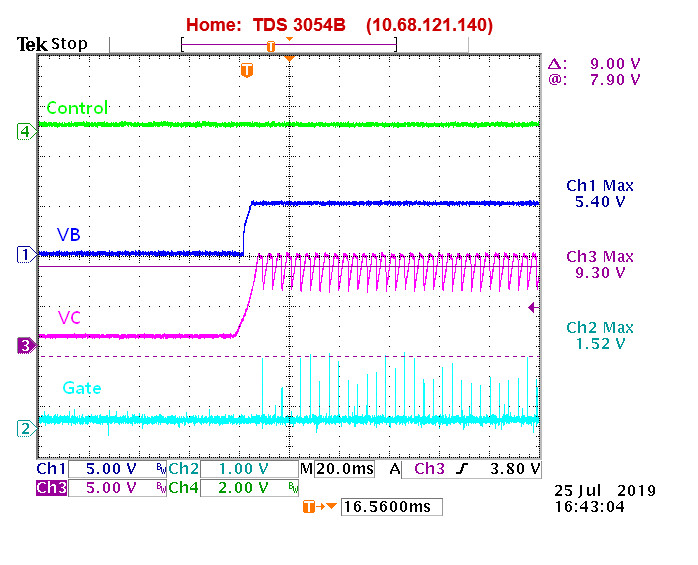

I built a PD board with this part and when I connect to PSE board, ths PSE board can indetify the PD board in class0. but the VC and GATE are unstable. the waveform are as below
do you have any comment abbut it?
thanks

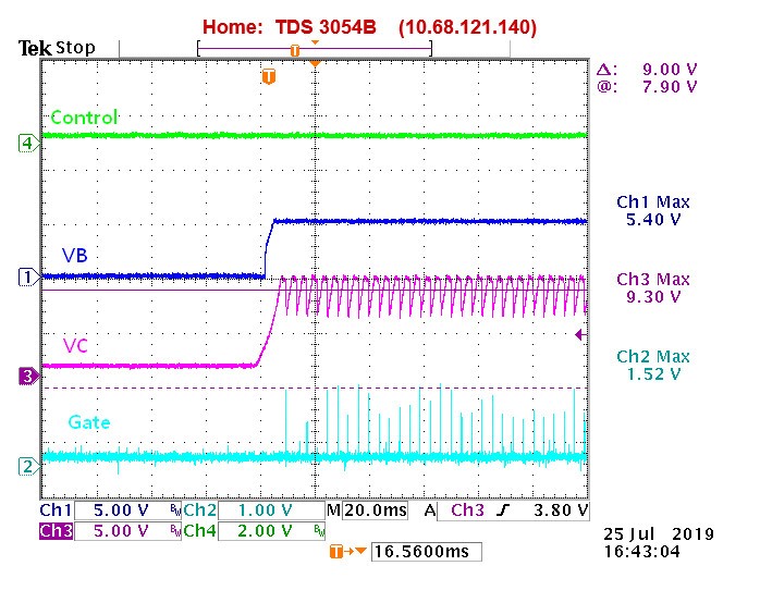

    Thank you so much for the screen shots. Can you please provide a schematic of your system for review? It would help me understand how you have your system set up as well as check component values. It is hard to say definitively what could cause this problem without it.
    Additionally, can you capture the startup sequence on VDD and Vout? I am curious to see how those pins are behaving and if that can tell us more information. Thank you!

  • Hello Michael
    the design concept is 5V/7W output

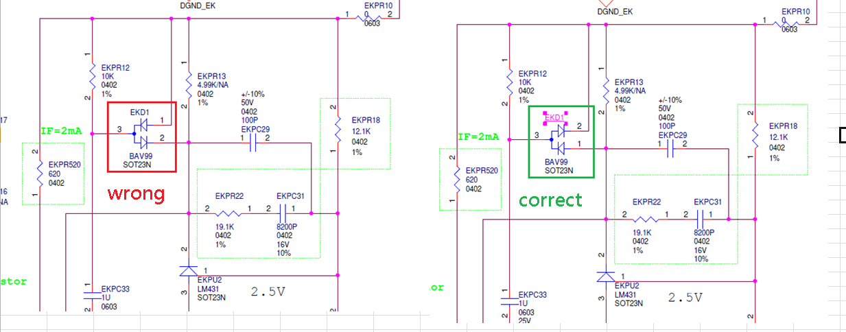

    finally, I found there is something wrong in my schematic design(please see attached file, ) and I also found the TPS23753A is damage.
    the behavior is
    1. when BAV99 is in wrong design and I plug PoE injector, there is no 5V output and TPS23753A is damaged
    2. when I reworked the BAV99 first and then plug PoE injector, the 5V output is normal
    could you help me
    1. why it causes the IC damage
    2. what is the purpose for BAV99 circuit
    3. review the schematic
    thanks

  • Hello David,
    Thank you for providing the schematic. I am sorry to hear a board got damaged.
    The BAV99 is designed to have a small forward voltage, large breakdown voltage, and low capacitance. When hooked in the original configuration, it looks like the anode (pin 1) is connected to a higher voltage that is between the inductors. The cathode (pin 2) has a capacitor and the LM431 between it and ground. It could be possible that the voltage here was enough to discharge.
    Whereas, when you flip the device so that the cathod is connected to the higher voltage, the BAV99 has the large breakdown voltage which would prevent any current flow.
    Commonly this device is used for ESD protection, so that a discharge can have a safer path to take. I found this article that discusses the operation of the BAV99 in regards to using it as an ESD protection device:
    http://www.ti.com/lit/an/slva898/slva898.pdf
     However, all of this is happening on the output side of the transformer, so there could be another reason the IC is damaged. Unless the photodiode is transmitting the wrong feedback and that could cause damage to the IC. I am going to do a deeper dive into your schematic and we can discuss more. Do you have any questions on this?
