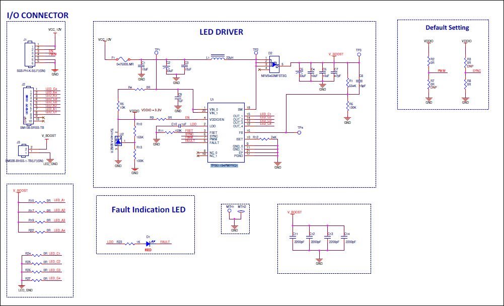

TPS61194-Q1: LED Driver IC Fault issue
Part Number: TPS61194-Q1
HI TI Team
I am using TPS61194-Q1 for one of our application for LCD Backlight. when Enable signal is High (3.3V), and PWM Signal is Low (0V), we are getting constant output voltage as 27V with reference to input supply ground as per the Feedback path configuration, Input voltage is 12V. But when Enable signal is High (3.3V), and PWM Signal is High (3.3V), the IC is giving as a fault and output voltage is droping to 12V with reference to Input Supply ground and there is no voltage with reference to OUT1/OUT2/OUT3/OUT4.
we are connecting resistor as a load between VBoost and OUT1/OUT2/OUT3/OUT4 for Load Testing instaed of LCD Display for testing the card.
Please find the schematic for your reference.
Kindly suggest what could be issue for Fault and how to overcome the issue. Kindly let me know if there is mistake in providing the input to the IC.
