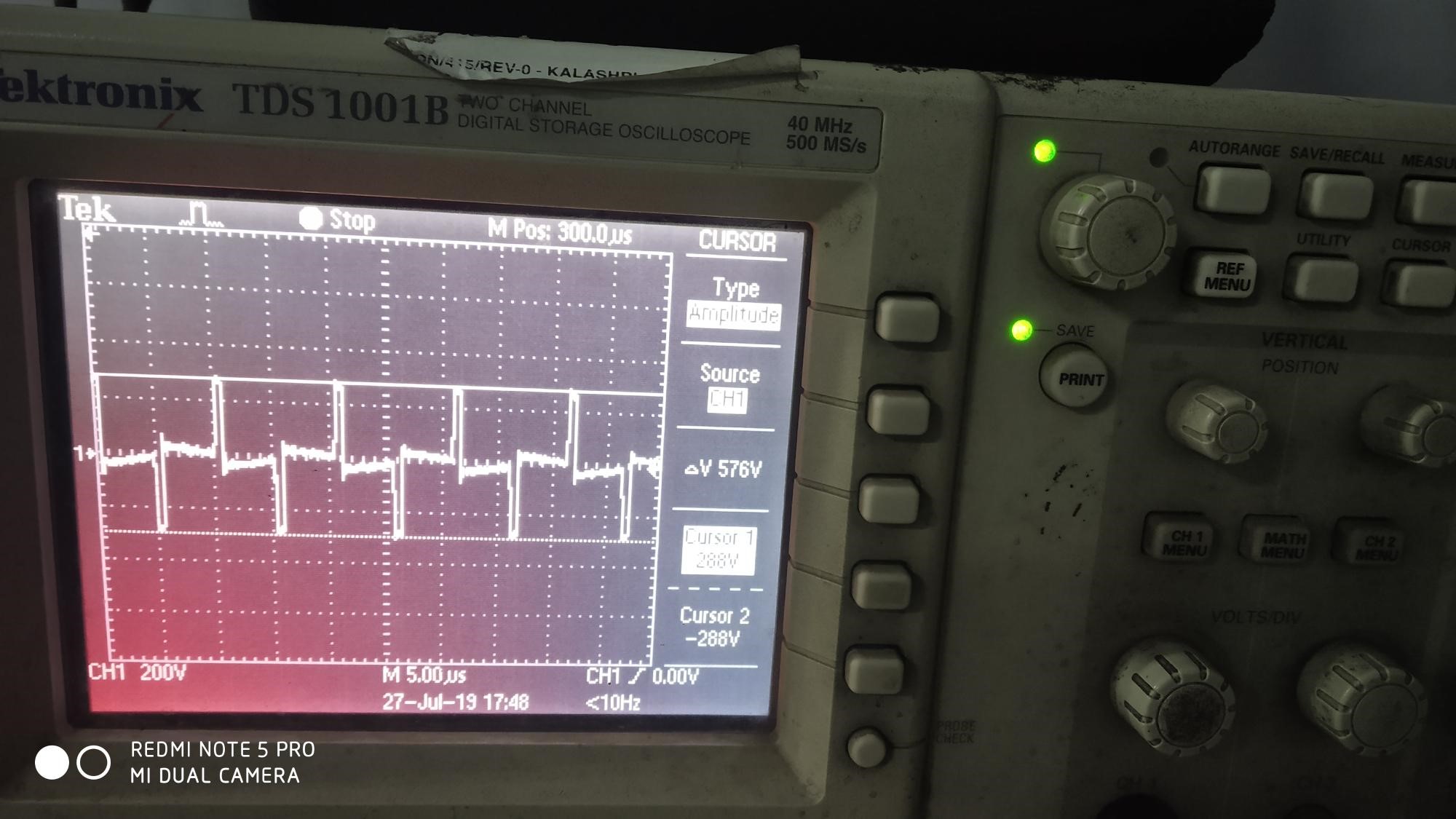

At the time of testing I am bypassing Q12-Q31 MOsfet bank by putting wire link from C53 to J8 +, I have connected dcdc card to simple rectifier card and giving 12V to VCC_FB on J5 connector from external power supply. Now in this case I get stable 54V output when I gave 190VAC from variac. but my external power supply get loaded and input current I got from ext. power supply is around 1 A.
Also the waveform of T4 primary winding are like attached snapshot. are they ok ?
  • Dear Anjana,
    The second waveform is correct, because there is no load on 54V (isn't it?) and therefore the feedback loop is closing the driving pulses.
    BTW, what is the first screenshot? Is it the T4 primary voltage at lower VAC?
    Second: at 12V the current consumption is too high: it should not be 1A; it will be 1A only when the fan is supplied at maximum RPM and all housekeeping is supplied at nominal load (so uC running, display on, backlighting on and top-speed for the fan).
    Roberto
  • Hi Roberto,
    Yes another waveform is T4 primary at lower input voltage.  But my previous waveforms were much clear with lesser spikes inbetween two zero ( ref line of oscilloscope channel) crossings, also when feedback get closed at the same channel reference line you can see slope like line ,previously i got it very straight horizontal line.
    Regarding to external ps current, today i found that communication ic was dammaged.
    Anjana
  • Dear Roberto,
    here I am attaching previous and recent waveform of T4 primary winding, please check and tell me is recent wf correct? or something is wrong with it.
    Also, if I want to use IXFP72N30X3 mosfet in place of synchronous rectifier what changes I should  do in gate driver circuit?
    Anjana
  • Dear Anjana,
    I am not sure why the two waveforms are slightly different: can it be that in one situation the sync. rectification is not active? In this case, a small magnetizing current will flow on primary side (since the primary winding is not open during Toff but shorted) and therefore the voltage will be different, but I cannot confirm it.
    Regarding the MOSFET IXFP7xxx, this is a slower switch compared to the original one, so, please, double check that the extra turn-on delay (here 86 nsec) is not impacting the efficiency (you will see this by watching the output voltage of the current sense transformer (T1); this voltage can be seen across R34; if you have cross conduction, you will see voltage spikes on R34.
    Roberto
