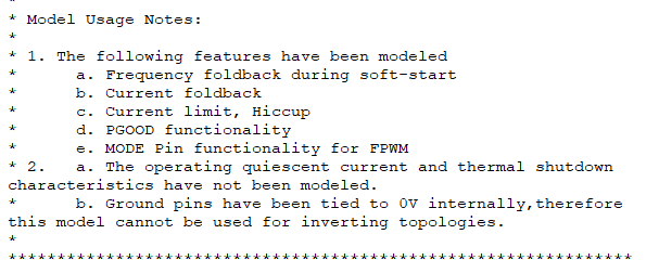

    2. I don't think the simulation file has the external synchronization feature modeled into it. Below is an image of the available features that can be tested for this model.The simulation result you see most likely is not representative of what the output votlage should be.

  • Hi Yusuke-san,
    I wanted to clarify that the model does include the SYNC functionality. It is part of the MODE pin functionality for FPWM.
    Can you confirm that you were able to do the following in SPICE:
    1-If you put an external clk on Model/SYNC, it should override the frequency generated internally by RT pin after some time.
    2- If Model/SYNC is pulled low, the part function in DCM at light loads and in CCM mode at higher loads with the freq. set by RT pin
    3- If Model/SYNC is pulled High, the part function in CCM , no matter what load you have attached.
    Similar to my comment on your other post, since TI does not use LTSpice, if there are any syntax issues that is preventing you from simulating the model properly, you will need to contact the appropriate software developer to get the model to converge.
