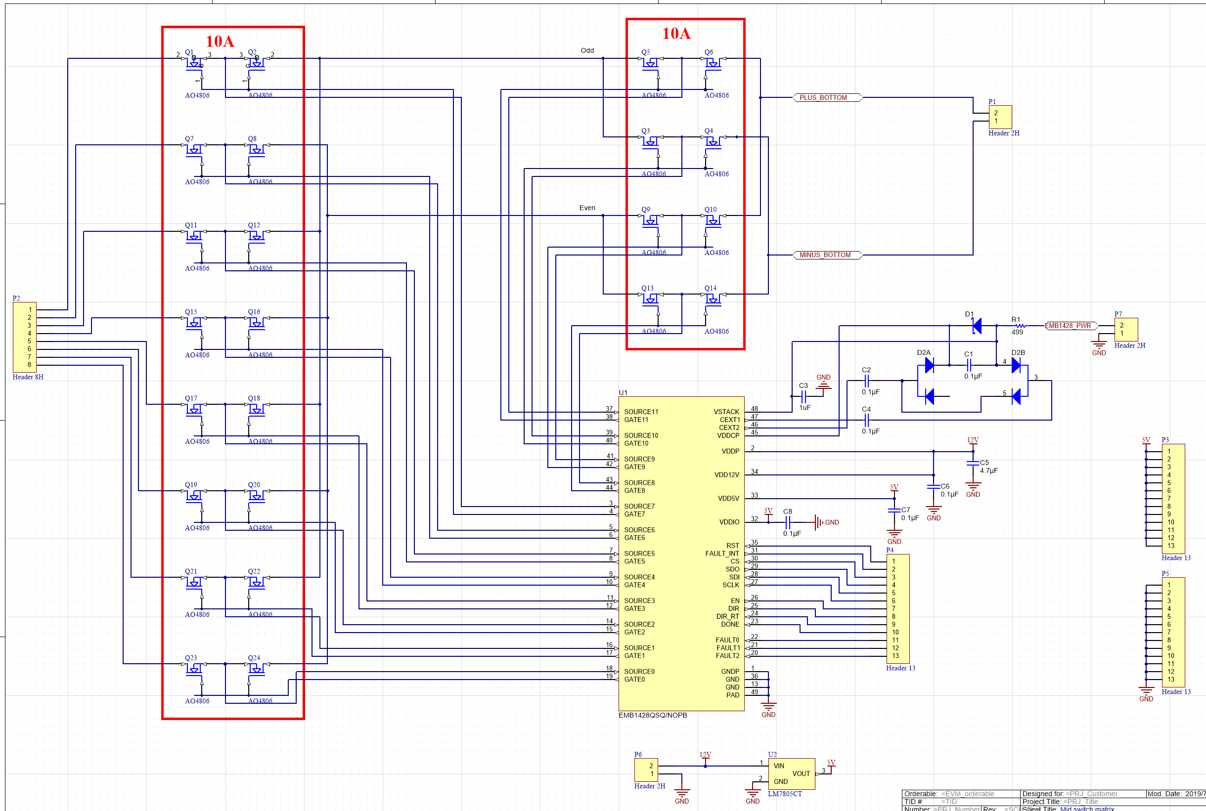

We're developing EBM1428. But remove the EMB1499.
We have some SPI issue now.
Please check below picture.
This is our schematic:
We only modify MOSFET switch. And we made a EMB1428 only board for testing charge pump and SPI.

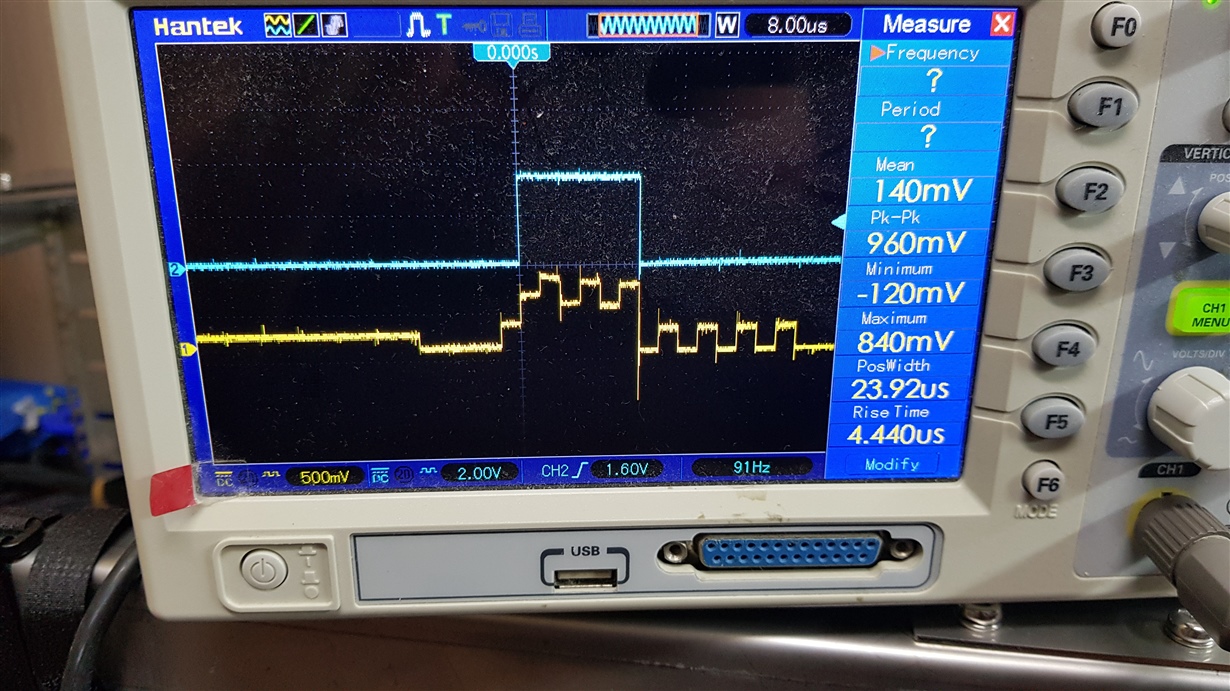

This is our SPI signal:
CH1(Yellow)=EMB1428 SDO
CH2(Blue)=MCU SDO
SPI/GPIO state information:
CLK:250KHz
CPL=LOW
CPHA=1Edge
Level:3.3V
Below picture show MCU send "0x70" to EMB1428.
GPIO
RST=5V(High)
DIR=float
DIR_RT=float
EN=float
DONE=float
Issue
EMB1428 doesn't output correct level and correct waveform.
