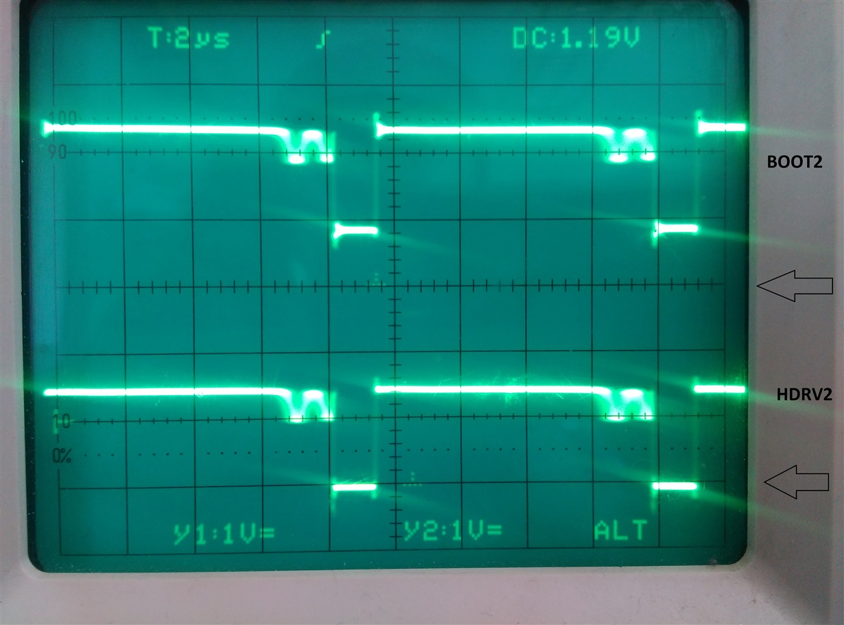

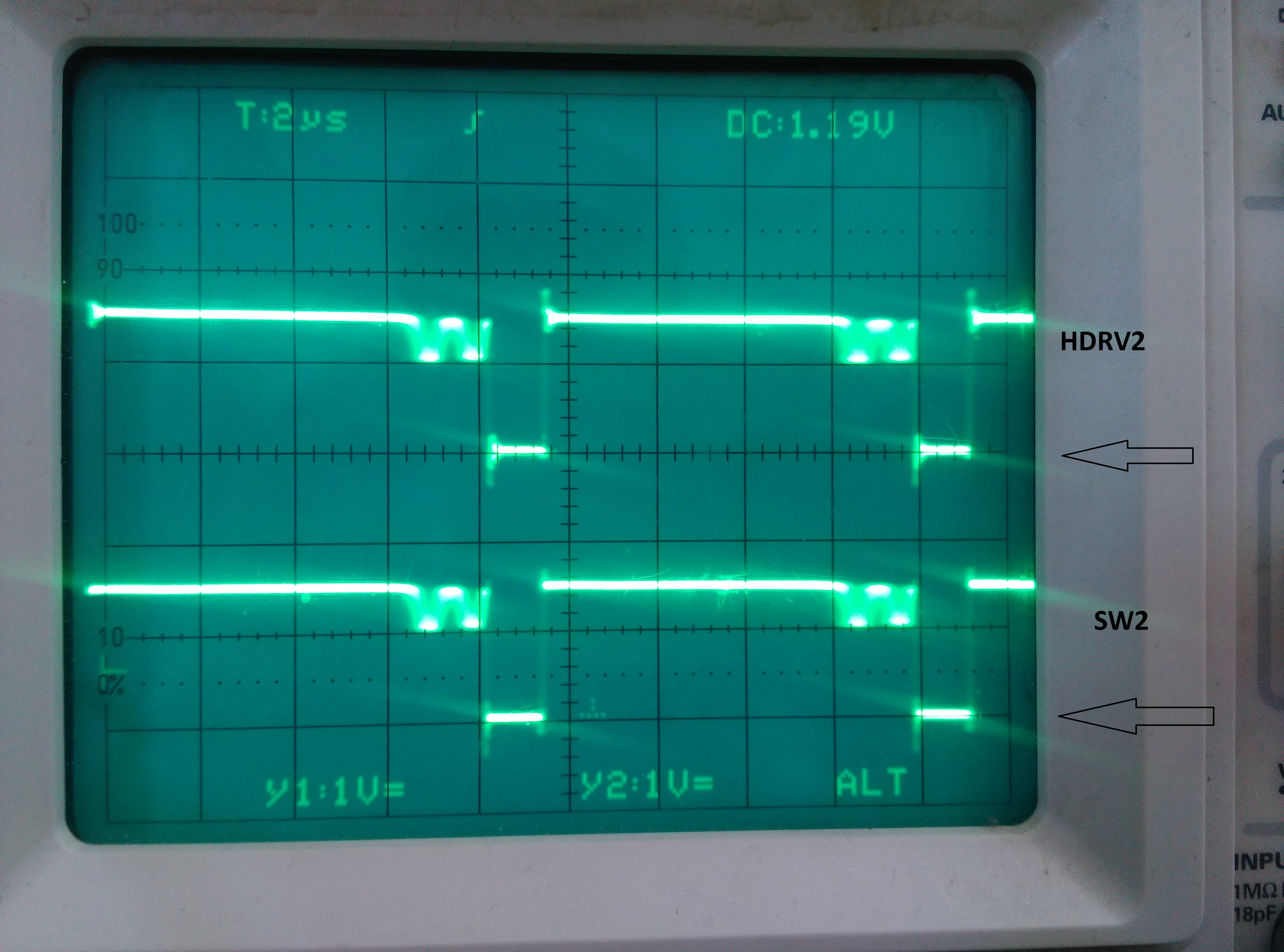

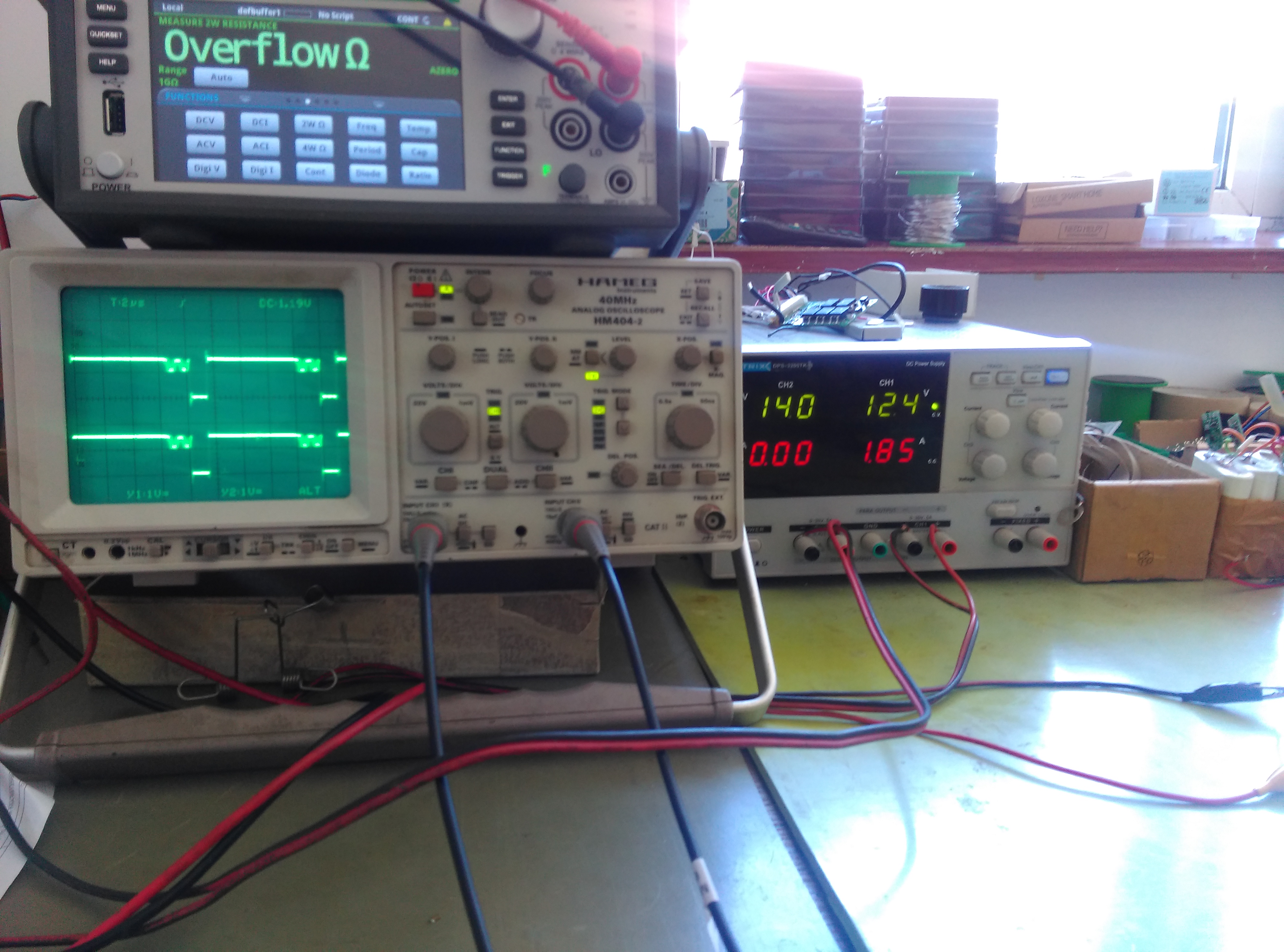

  • I came back with another photos  :
    below you have : power supply : 12 V input;
    output voltage 13.8V
    in first photo you can see SW2 and HDRV2 voltages referenced to ground. They are the same. Meaning the upper transistor does not switch
    The arrows indicate the ground / zero voltage level
    In the second photo you can see HDRV2 and BOOT2 voltages referenced to ground. So bootstrap circuit is ok.
    Also
    look the power supply  (when measuring SW2, HDRV2) 12.4 V / 1.8 A

  • Thank you for the pictures, but I don't see any difference between your 1st and 2nd scope pictures, in which you said the 2nd was about HDRV2 and BOOT2.  Did you post a wrong picture there?  Anyway, the 1st picture shows DCM: the resonance at the end of the waveform of SW.
    (HDRV2-SW2) and (LDRV2-GND) will always be in complementary in CCM.  The complementary will be lost in DCM, because the HDRV2 would turn off earlier.

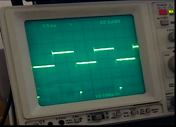

  • We have encountered this behaviour on several boards with lm5175 and lm5176. And strange enough this happens only when the load is a battery or a resistance. With electronic load hdrv2 does switch.
    I don t think the driver inside LM5175/LM5176 is faulty because under certain conditions we can see gate pulses on HDRV2. It is something with the driving logic part.

  • The purpose pf the photos was to show  you that HDRV2 is not equal with SW2+Vcc , despite the fact this voltage does appear at BOOT2. How can this happen for a high side driver? Or can this be because of the proprietary circuit of the gate drive
    which works even if one leg of the bridge does not switch in order to recharge the boot cap ?
