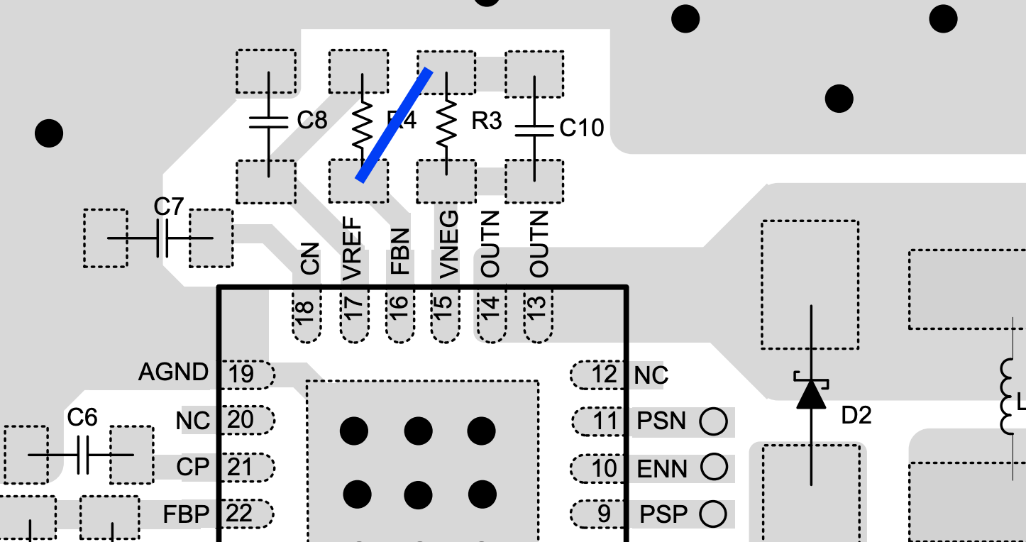

I am trying to follow the suggested layout on page 24 of your data sheet. A few questions:
How do you recommended tying ENP, PSP, ENN, and PSN signals to VIN? All Shorted together and one via underneath package to VIN ?
Should VNEG at pin 15 by tied to the VNEG pad (bottom right of layout)?
Also, should thermals be used on the pads?
And finally, shouldn't there be a connection between R4 and R3 as shown in the blue below?
