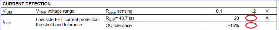

Hi Team
Would you advise that my customer is facing OCP issue then I made easy check
excel file attached.
1.Is attached calculation right?
2.Can you advise max values red circle below?
ShidaraTPS543B20 Ocp.xlsx
Hi Team
Shidara,
Your calculation is correct. I doubt if we have the data, but I will check.
Shidara,
My data indicates that the tolerance on the overcorrect may be better than +/-15%. Please use +/-15% as the tolerance.
