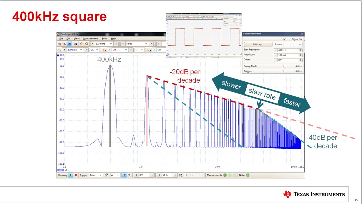

I wonder know what is the following 150MHz & 50MHz meaning?Is it represent the switching frequency or what?
With RBOOT short circuited to CBOOT, rise time is rapid. SW node harmonics will not roll off until above 150
MHz. If CBOOT and RBOOT are connected through 700 , slew time due to high side turn on is limited to no
more than 13 ns, 10 ns typical when converting 13.5 V to 5 V. This slow rise time allows energy in SW node
harmonics to roll off near 50 MHz under most conditions
Very appreciate for answering!

  • Hello Edward,
    If the spectrum of the SW node waveform is plotted, there is a frequency at which power starts to roll of at 40 dB / decade rather than 20 dB / decade. I am attaching a slide from training.ti.com that shows this pattern.
    It is the frequency that the change in slope of the power density vs. frequency curves that is being referred to.
