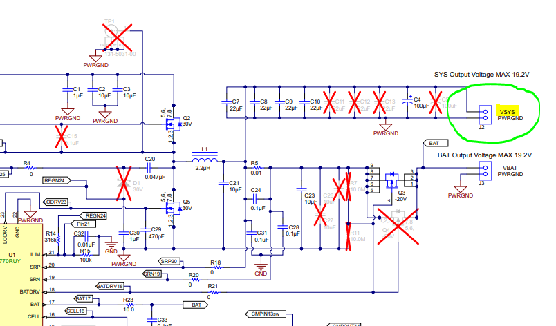

Hello TI,
               Previously we are working with BQ25895 that's why we are using TPS61088 to avoid Boost mode enable delay because of that 30msec delay of Boost mode Enable is sufficient to reset my system (Raspberry PI 4) there is drop in PMID voltage in 30msec time slot, as per the TI suggetion we repalce BQ25895 with BQ24773 becasuse of to improve load handling capacity and avoid the heat sinking of BQ25895 at max output power.
we not observe any enable/disable delay in BQ24773, please inform us if there is any Output voltage ON/OFF delay in BQ24773
as per the mention application circuit and evaluation board bill of material mention active components (MOSFET) turn on/ turn of delay is in 'ns' which not affect on system load, there is any other point which we missing in that system
1.We need use boost converter with system .if yes, please explain why we need..?
2.Output Load of the system is 5V and 5A, BQ24773 can provide required load power..?
3.What we need to take precaution to achieve more than or equal 25w output Power ..?
Thanks & regards,
Rahul Surawase

  • Hello Joel,
                      As per the register Understanding after the looking register setting,
    MaxChargeVoltage() and MinSystemVoltage() used to set the Charging voltage threshold for safely charge the cell, the register decide the battery Output voltage....If yes, plz explain How ..?
    1.We are using 5V/5A input adapter to the system
    2.Output requirement of the sysetm is 5V/4A
    3.we use 1S Lithium Polymer battery pack of 5000mAh capacity (as per the manufacturer, charging voltage 4.2V and output voltage is 3.7V )
    It is possible,
    1.System without Boost converter to get Continuous 5V/4A Output on Individually Input source and Battery
    2.How to get Output 5V/4A on Input source adapter ..?
    3.How to get Output 5A/4A on battery power system without input source(OFF) ..?
    There is some thread which i discuss earlier,
    1. https://e2e.ti.com/support/power-management/f/196/t/831008
    2. https://e2e.ti.com/support/power-management/f/196/t/829955
              please suggest the solid solution, thank for your quick response
    Thank and regards,
    Rahul surawase

    In the interest of optimizing the charging time and also sustaining your 5V system load, I would suggest tying the system to the ACN rail and add a boost converter from the SRP node to regulate the ACN rail when your input source is removed. Tying to ACN will provide a nature isolation between the adapter plug in and the system load.
    Joel H
  • Hello Joel,
                      Yes, we are using Boost converter after the SRP filter as i share image of EVM Board Sch
    Rahul surawase
  • Hey Rahul,
    That should be fine, and the output of the boost converter AND the system load should be tied to the the ACN net (also the drain of the Q2 HSFET).
    Joel H
